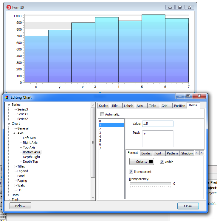

Using the chart editor on the form designer, you can freely alter value and text of TAxisItems. See attached picture. That's pretty cool.
This shows how it works flawlessy during design time

What you need to do is set Axis.Items to manual. If, they are automatic, their values won't be used. If you have a look at the editor screen-shot you posted, to be able to set Axis.Items values manually, you need to uncheck the "Automatic" checkbox. At run-time you can do this:
