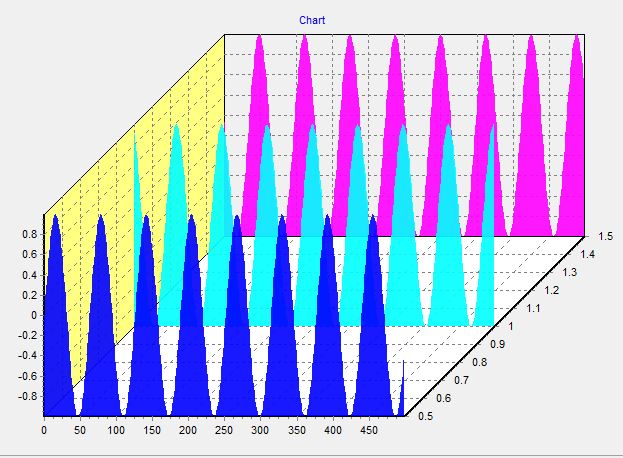

As showing in the attachment waterfall3d.jpg created in c++ with TeeChart, the area under the series are painted.
long id = ptChart->AddSeries(tchartNS::scWaterfall);
	tchartNS::ISeriesPtr ser = ptChart->Series(id);
	ser->Pen->Visible = false;
	ser->asWaterfall->UsePalette = false;
	ser->asWaterfall->WaterLines->Visible = false;
	ser->asWaterfall->Transparency = 10;
	ser->asWaterfall->Waterfall = true;
	ser->asWaterfall->IrregularGrid = true;
	ptChart->Aspect->Chart3DPercent = 75;
	ptChart->Axis->Depth->Visible = true;
	m_ptChart->Aspect->View3D = TRUE;
	double x = 0.0;
	_bstr_t b;
	for (int i = 0; i < 500; i++)
		ser->asWaterfall->AddXYZ(i, sin(x + i*0.1), 0.5, b, RGB(0, 0, 255));
	x = 2.0;
		ser->asWaterfall->AddXYZ(i, sin(x + i*0.1), 1, b, RGB(0, 255, 255));
	x = 3.0;
		ser->asWaterfall->AddXYZ(i, sin(x + i*0.1), 1.5, b, RGB(255, 0, 255));

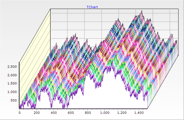

Post by Yeray » Thu Feb 13, 2014 11:09 am
The images you posted look too different to be compared. The data and the number of series is very different. With so few series the space between them is bigger, ad I'd expect.
I've been doing some tests and I think the best way to draw such a chart is to combine TLineSeries with TSeriesRegionTools.
Here it is the code I used. It's in Delphi but you shouldn't find too much problems to translate it into C++; otherwise let us know.
uses Series, TeeSeriesRegion;
var i: Integer;
  Chart1.Chart3DPercent:=10;
  Chart1.Aspect.OrthoAngle:=60;
  Chart1.Legend.Visible:=false;
  for i:=0 to 34 do
    with Chart1.AddSeries(TLineSeries) as TLineSeries do
      Depth:=0;
      Pen.Color:=RGB(Random(256), Random(256), Random(256));
      if i=0 then
        FillSampleValues(1500)
        DataSource:=Chart1[0];
    with Chart1.Tools.Add(TSeriesRegionTool) as TSeriesRegionTool do
      Series:=Chart1[i];
      Pen.Visible:=false;
      OriginPen.Visible:=true;
      OriginPen.Color:=Series.Pen.Color;
And the result I've obtained:
