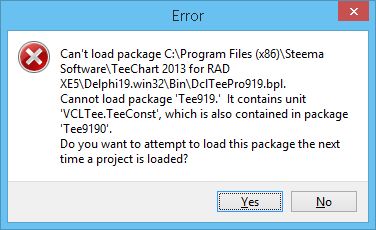

Just installed tee2013 Pro VCL into freshly installed DXE5 Update2.
Until that moment everything worked OK.

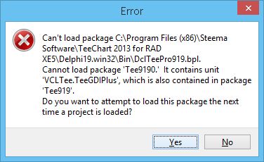

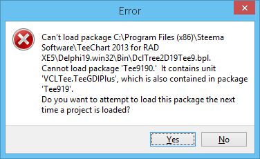

After, I get following 3 error messages when starting Delphi.
Some advice?

Post by Narcís » Fri Feb 07, 2014 3:30 pm
Hi Pavel,
This error message indicates that your XE5 is still loading the TeeChart Standard packages it includes. You should answer Yes/OK to all those questions, disable TeeChart Std components and enable Pro version ones. You'll find more information about the same problem here.
