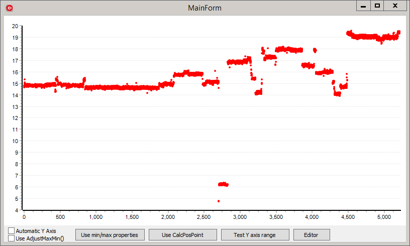

Note you are not repainting the chart between changing some chart properties and retrieving some others.
Alain wrote:So, if the "Automatic Y axis" checkbox is unchecked and button "Test Y axis range" is clicked:
- The Y axis range as shown by the graph is 3 to 21

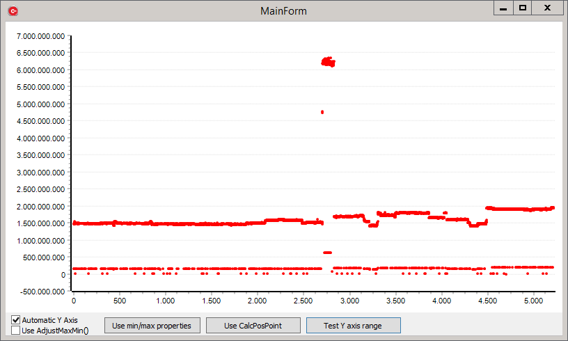

Not for me here. Note this is what you see when you start the application:
Then, after clicking the "Test Y axis range" button, this is what I see:

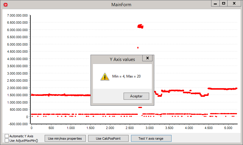

Where do you see a 3 to 21 range in the left axis?
Alain wrote:- The range returned by the CalcPosPoint() method is 4 to 20 (not correct !).
Yes, this is what I see, but it's correct. You've added values to the chart but note you haven't repainted the chart after it, so the axes values haven't still been recalculated.

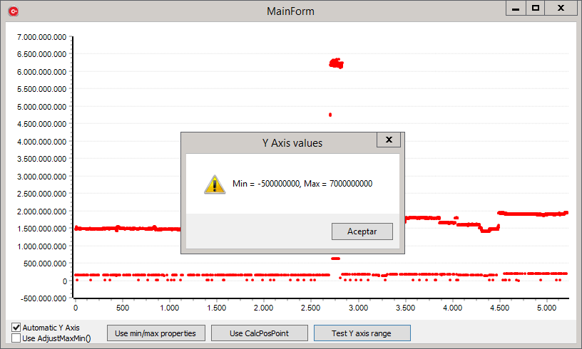

Alain wrote:- The "automatic Y axis" checkbox becomes checked (since the Y axis is now in automatic mode).
Same for me here:
Re: Wrong axis min/max values for automatic axis
Post by Yeray » Wed Feb 19, 2014 4:40 pm
I continue...
Alain wrote:If we click on the "Test Y axis range" button a second time, leaving the "automatic Y axis" checkbox checked:
No for me here. This is what I get the second time I clicked the same "Test Y axis range" button:
Alain wrote:- The range returned by the CalcPosPoint() method is 3 to 21 (correct this time).
Not for me. See image above.

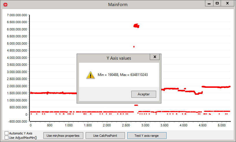

Alain wrote:Now, if we uncheck the "automatic Y axis" checkbox and click on the button "Test Y axis range" again, the results will depend on the status of the "Use AdjustMaxMin()" checkbox:
- If unchecked (AdjustMaxMin() is not called), the range returned by CalcPosPoint() is 4.73 to 19.54
I get 190.488 to 6.348.110.243:

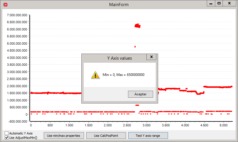

Alain wrote:- If checked (AdjustMaxMin() is called), the range returned by CalcPosPoint() is 4 to 20.
I get 0 to 6.500.000.000:

Alain wrote:We are not sure why our sample program gives you a different result and behavior. You are indeed using the same version of C++Builder and TeeChart than us.
It seems we have different locales. I've added this to your project to be sure the '.' is taken as the decimal separator and not as the thousand separator.
	SetLocaleInfoA(GetUserDefaultLCID(),LOCALE_STHOUSAND,",");
	SetLocaleInfoA(GetUserDefaultLCID(),LOCALE_SDECIMAL,".");
Then when the application starts, I see this (I've also added a button that opens a TChartEditor):
Now the values look as the ones you were talking about. And everything behaves as you detailed in your previous messages.
