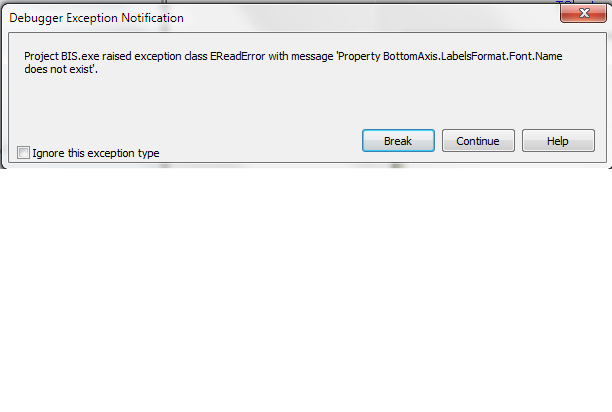

After I installed the latest VCL in Delphi XE3 and compiled en run an older program I get an error message when I open the form with a TChart on it (see attachment) When I remove the TChart the form gives no problem.
When I put a TChart again on it the problem is back again.
Can you help me?

Hello Henk,
This is quite strange, this property should still work. You can try changing it to Chart1.Axes.Bottom.LabelsFormat.Font.Name. If the problem persists please attach a simple example project we can run "as-is" or let us know the exact steps we should follow to reproduce the problem here.

I ported the program to Delphi XE5 with a clean install ans the problem was gone.
Is it possible that in XE3 there where leftovers from a previous install?
BTW your suggestion did not solved the problem.
I now go with XE5, so no problem.

Hi Henk,
Yes, maybe package/units references from different versions.HenkBoog wrote:Is it possible that in XE3 there where leftovers from a previous install?
