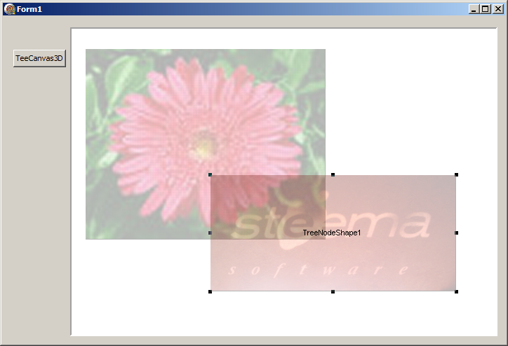

I'm not sure about what exact TeeChart version are you using but I see the transparencies with GDI (TTeeCanvas3D) here with TeeChart v2013.09:
Find the project attached:
TeeTreeAndSlowGDIPlus.zip
(915.47 KiB) Downloaded 1357 times

With GDI+ the background of picture I added, has a background transparent (It's a PNG)
If I clic on the button, it switch in GDI,after this, the picture has not a background transparent

I could reproduce the problem so I've added it to the bug tracker:
http://bugs.teechart.net/show_bug.cgi?id=561
Feel free to subscribe to the ticket status by adding your mail to the CC list.
