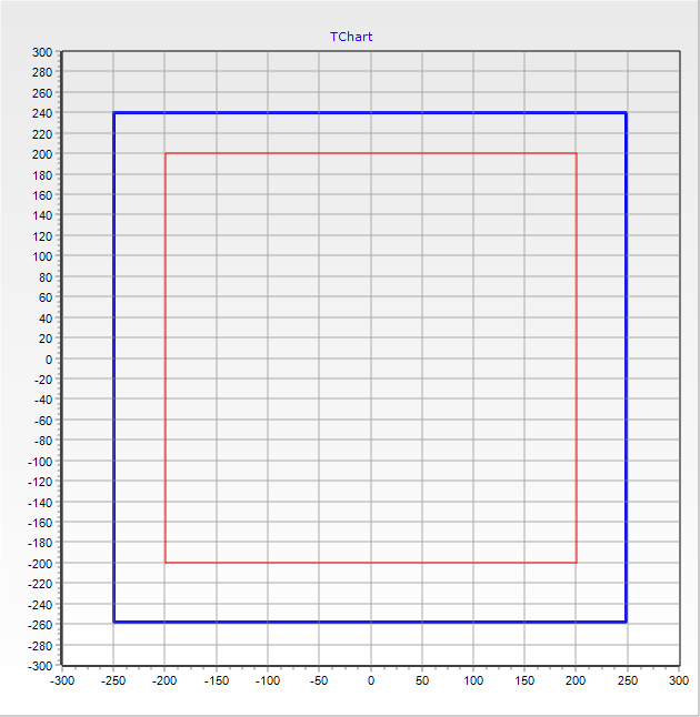

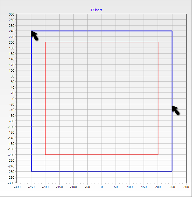

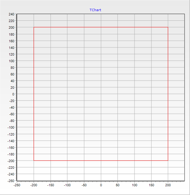

I have a problem zooming and keeping the aspect ratio. I use the mouse to zoom, dragging the mouse down and right. When I release the mouse button, it seams that the redraw function uses the mouse position as the lower right corner of the zoom area and not the lower right corner of the ZoomRect.
If I am positioning the mouse exactly at the lower right corner of the ZoomRect and release the mouse button, I get the expected zoom. If I am positioning the mouse away from the lower right corner of the ZoomRect and release the mouse button, I get a zoom using the mouse position as the lower right corner, not keeping the aspect ratio.

Your result looks as it shall, that is also what I get the most of the time but if I provokes the program just a little (not putting the mouse exact at the corner of the ZoomRect), it will give the result I was sending to you.

The problem is the KeepAspectRatio, when this is true the lower right corner of the ZoomRect is not following the mouse because it is keeping the aspectratio. Some times there is a big different between the lower right corner of the ZoomRect and the mouse and if you releases the mousebutton at this time you get the error.
