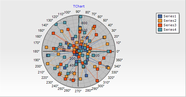

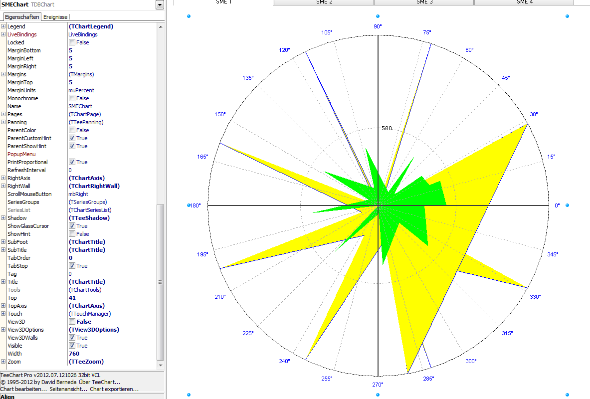

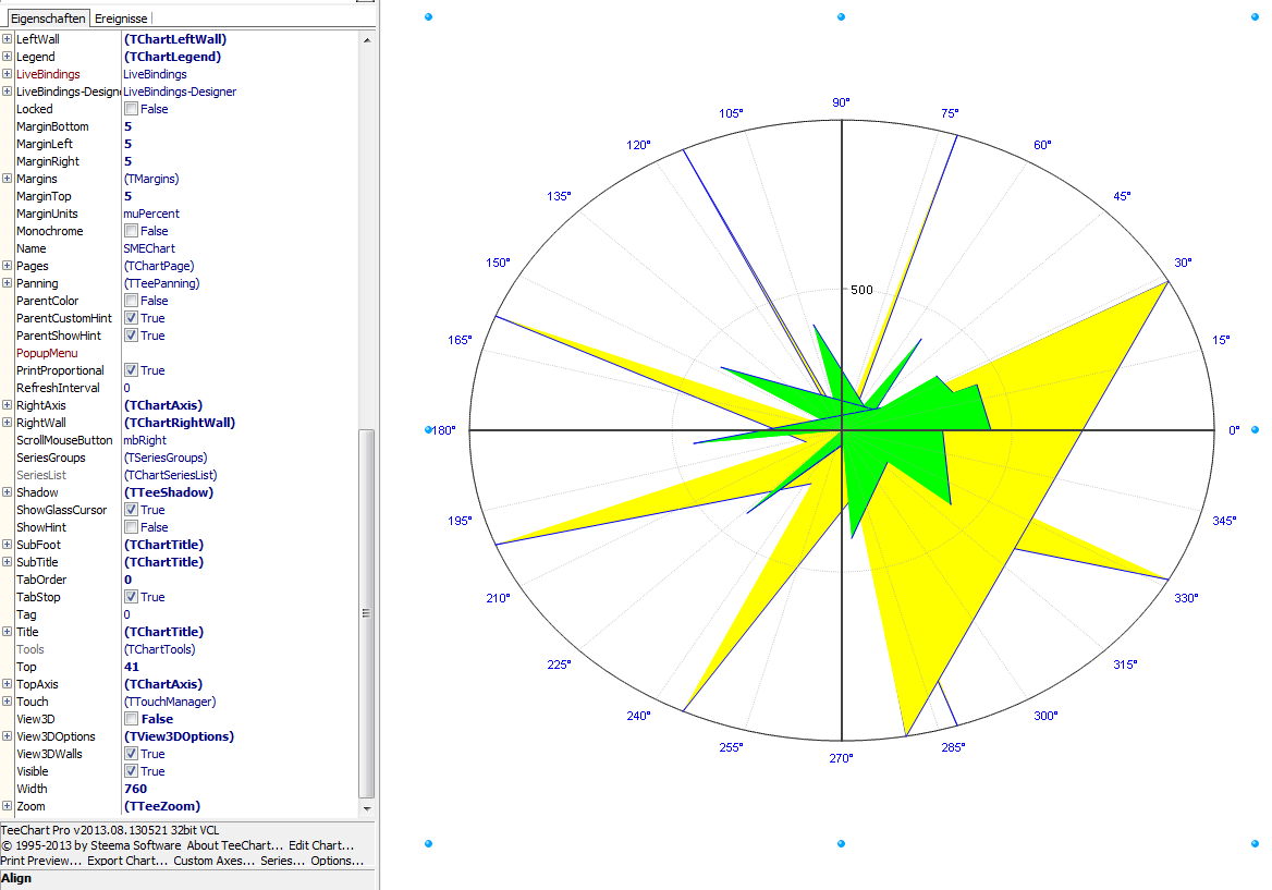

a polar chart that was round in all compilers starting from BDS2006 to Delphi XE3 turned from round to oval in XE4.
However, it is not Delphi, other round components are still drawn round.
Please look at the images, the Teechart versions are displayed there.
Gerhard Sachs
Gerhard Sachs
- Oval.PNG (116.78 KiB) Viewed 18285 times
- Round.PNG (91.22 KiB) Viewed 18232 times

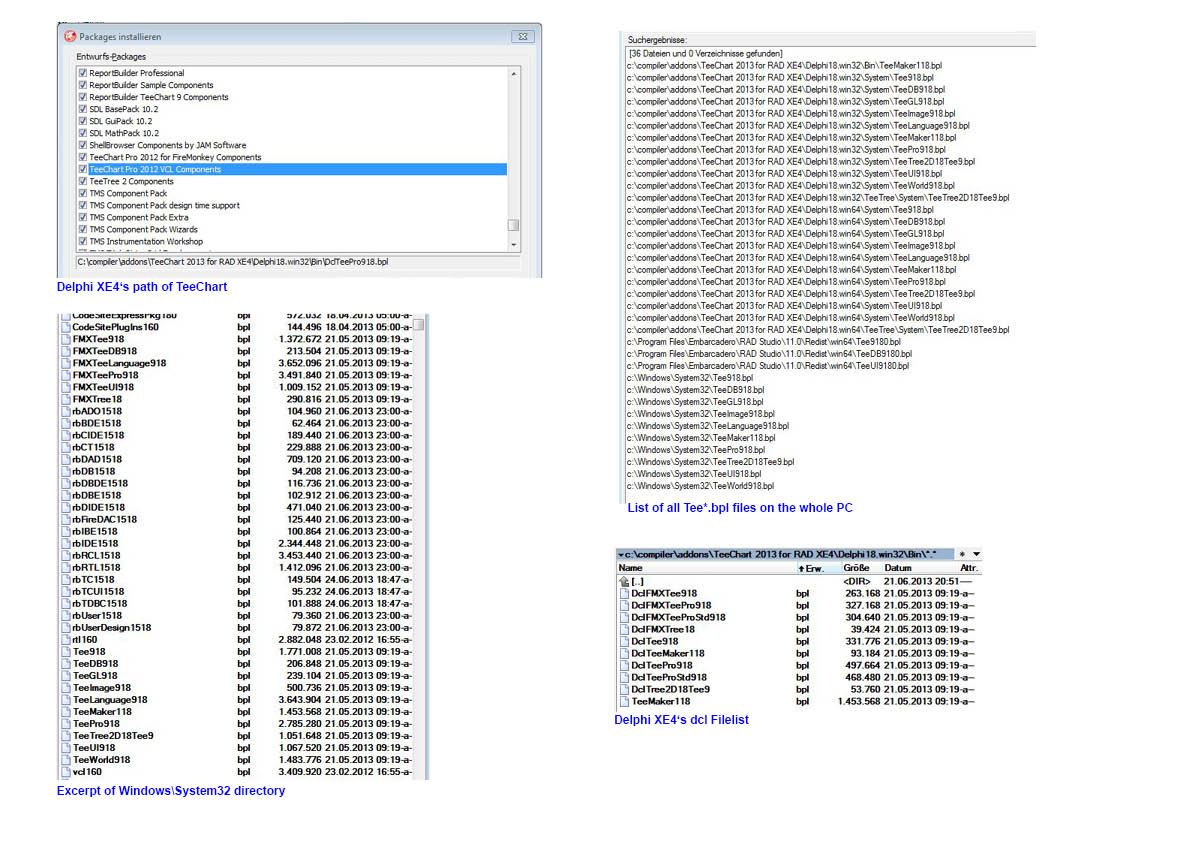

Hello Yeary,
I looked on the whole PC for old TeeChart files but did not find any.
Here are 4 screenshots that shows a list of all TeeChart bpls that exists on this PC.
A binary compare of the same named 32Bit bpls showed they are identical.
The PC is a Virtual machine running on Oracles Virtual Box.
I did a fresh Installation of Windows7/32, Delphi XE4 and TeeChart9.
This is the errror message I receive :
[dcc32 Fataler Fehler] CircledTest.pas(8): F2051 Unit VCLTee.TeePolar wurde mit einer unterschiedlichen Version von VCLTee.Series.TCircledSeries compiliert
It is a new VCL Project with just one Tchart and one Polar Series.
Gerhard Sachs
Gerhard Sachs
- TeeChart Filelists.jpg (177.93 KiB) Viewed 18150 times

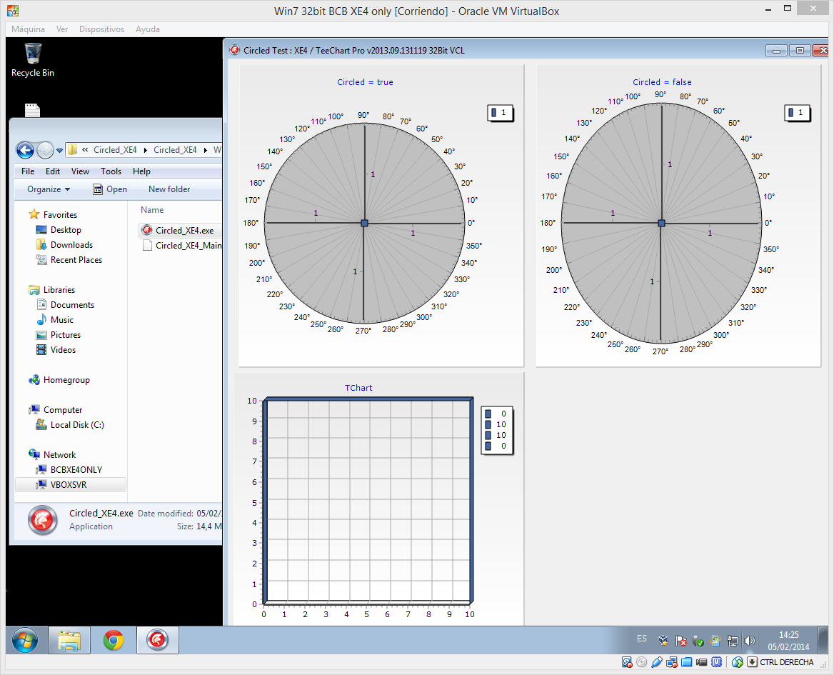

Hello Gerrard,
This is what I get in a Windows 7 x64 in a Virtual Box with your application built in a Win8 x64: It looks fine for me here.

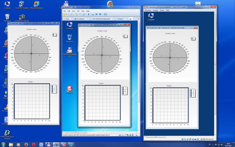

Here is a screenshot from my Desktop pc.
Both Virtal Box and VMWare Desktop is running there.
The TeeChart exe is running on the host and both VMs at the same time.
Left is the host, middle VMWare and right virtual box.
The Image should be self explanatory.
Currently I stopped working with Virtual Box.
If VMWare is working as expected, I will move to it and everything is fine.
Otherwise I will drop all VMs and kick out everybody that wants to tell me that Virtual machines are a proven solution.
Gerhard Sachs
Gerhard Sachs
- 3 W7_VBox_VMWare.JPG (172.27 KiB) Viewed 18065 times
