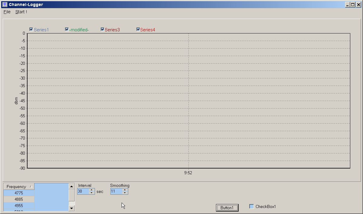

I use legend with checkboxes positioned at the top.
When at run time the text is changed, the checboxes move into the text, even if ColumnWidthAuto=TRUE.

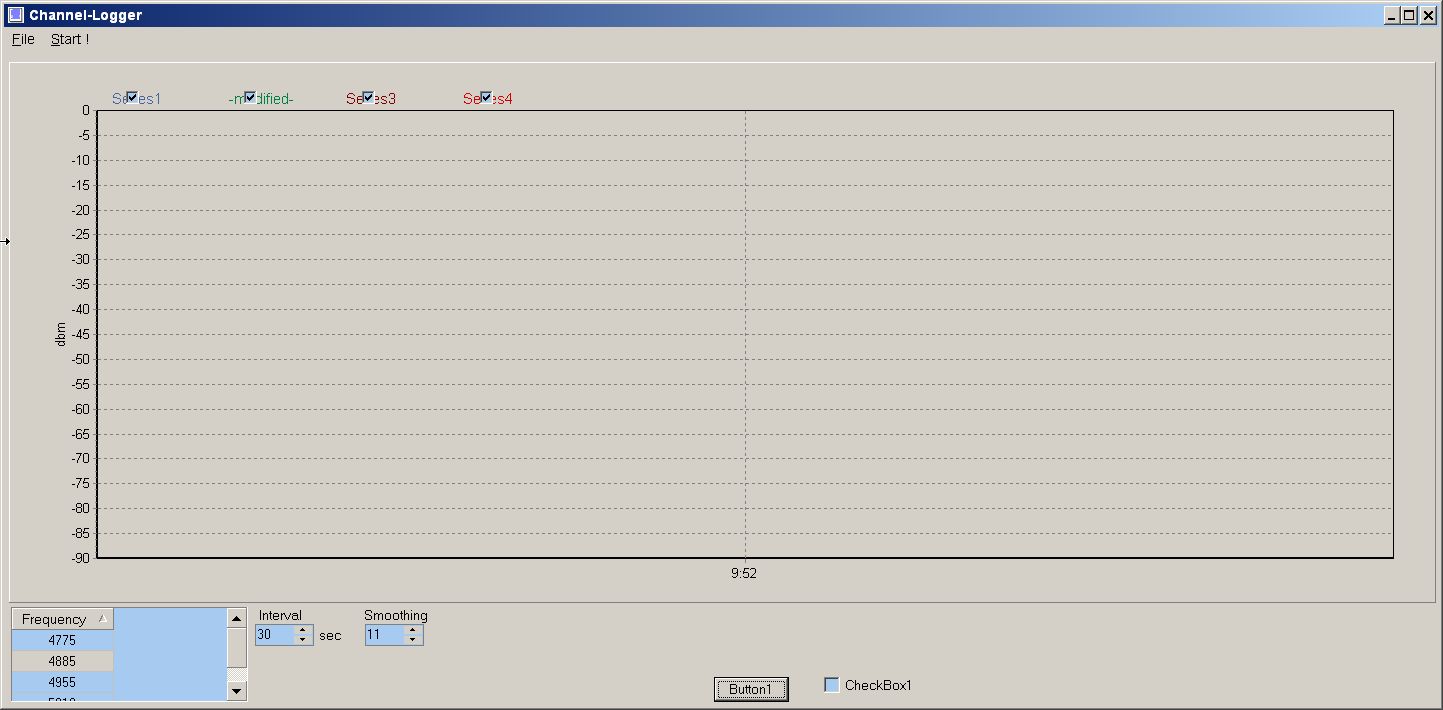

But as soon as the Tchart width is changed at runtime, the checkboxes move over the text again

Now you will see the effect that checkboxes are misplaced
Also: At runtime drag the right/left form border to make it wider / smaller, you will see that checkboxes are moved while the text-position remains unchanged.
