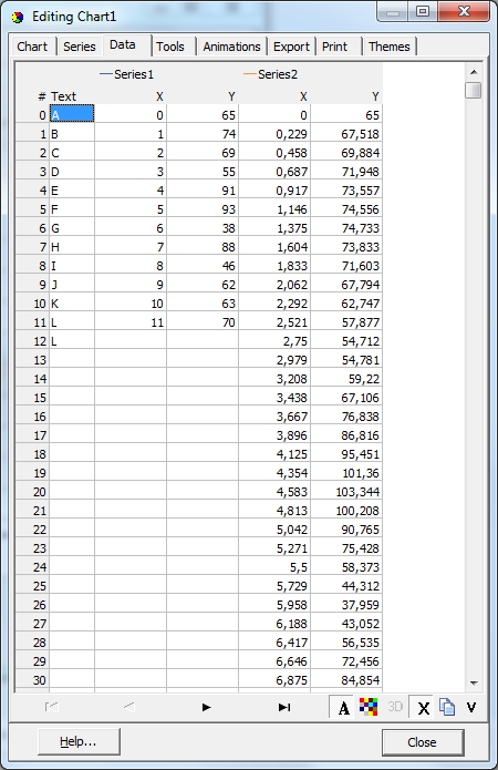

Post by Narcís » Thu Jan 09, 2014 9:19 am
Hi Fabio,
What happens here is that smoothed series has many more points than the original series. Original text labels are not related to X values but index values. Therefore, they only last for the first few points in the smoothed series. It's clearly seen at the Data tab in the chart editor:
An easy solution to your problem might be using custom axis labels, for example:
