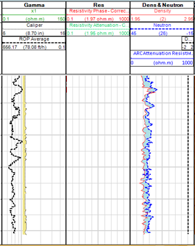

Is it possible to achieve this kind of layout as swimlanes?
richfit
Posts: 6
Joined: Tue Dec 24, 2013 12:00 am
Post by richfit » Thu Jan 02, 2014 3:29 am
I am using the latest version of TeeChart Pro 2013 VCL on Delphi.
If possible, only one or multi teechart can achieve this effect?
Many thanks in advance
Richfit

Hi Richfit,
I'd suggest you to take a look at the features demo examples. They will show you how to use the majority of features you'd need to achieve a similar chart as the one in your picture.
- I'd use THorizLineSeries as the series type. It has a Pointer property you could set Visible:=true. It also has the LinePen property, which can be used to make the pen wider (LinePen.Width:=3) or dashed (LinePen.Style:=psDash)
Ref: Features Demo example at "All features\Welcome !\Chart styles\Standard\Horiz. Line"
- I'd use the TSeriesBandTool to highlight the area between two series.
Ref: Features Demo example at "All features\Welcome !\Tools\Series Band"
- Depending on the exact needs I'd use CustomAxes, SubCharts or just ColorLines to divide the chart.
Ref: Features Demo example at "All features\Welcome !\Axes\Opaque zones"
Ref: Features Demo example at "All features\Welcome !\Tools\SubCharts"
Ref: Features Demo example at "All features\Welcome !\Tools\Color Line"
- You also have several options for the square on the top. You can use a CustomLegendTool, Annotations or custom drawing techniques.
Ref: Features Demo example at "What's New ?\Welcome !\New Chart Tools\Custom Legend Tool"
Ref: Features Demo example at "All features\Welcome !\Tools\Annotation"
Ref: Features Demo example at "All features\Welcome !\3D Canvas\Shape class"
