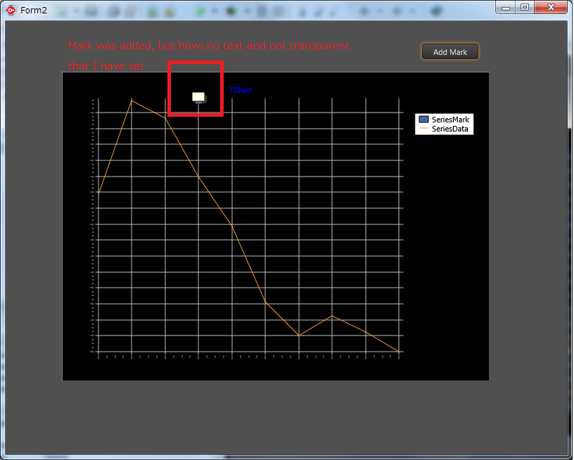

I want to add Marks at some index of series, but failed..
please help me!
Find the attachment for the example project!

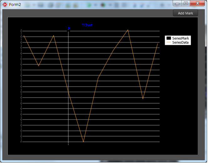

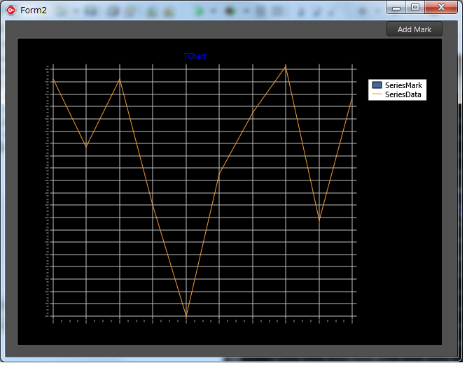

I know that the mark could be added directly by the code below,
but the grid also disapeared...
SeriesMark->AddXY(3, max, "N");
So I have tried to use the following code to modify mark manually.
SeriesMark->Marks->Item[3]->Text->Text = "N";
But it didn't work well...
In the case you want to continue displaying all the axis grid lines and bottom axis labels you have to set the bottom axis style to Value :
  Chart1.Axes.Bottom.LabelStyle := talValue;
elmec wrote:So I have tried to use the following code to modify mark manually.
Here you're correct, this is a bug, you should be able to set a specific mark text but using the code above, I testing it here the mark appear without text on it.
Could you please add it to bugzilla ? Doing so you'll be identified as the creator of the issue and therefore notified about its evolution.

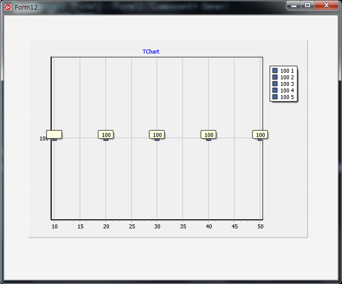

Post by elmec » Wed Jan 22, 2014 9:04 am
OK , I'd like to repeat the problem again.
---------Code-----------
	Series1->Marks->Visible = true;
	// Add 5 points to Series
	int xpoints[5] = {10, 20, 30, 40, 50};
	int y = 100;
	for (int i = 0; i < 5; i++)
		Series1->AddXY(xpoints[i], y, IntToStr(i + 1));
	Series1->Marks->Item[0]->Text->Text = "test";
But the result is as the attachment! There is no text on mark!

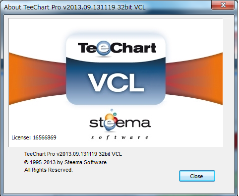

It's strange, it's working fine here with the latest TeeChart Pro v2013.09.131217 version usign the code you posted.
Could you please check which TeeChart version appears into your About box ?
elmec
Posts: 129
Re: Failed to add Marks manually
Post by elmec » Thu Jan 23, 2014 12:33 am
Hello Pep,
Find the attachment for the Teechart version and example project.
Marks.zip
(163.29 KiB) Downloaded 1026 times
teechart version.png (115.41 KiB) Viewed 28958 times
elmec
Posts: 129
Post by elmec » Thu Jan 23, 2014 12:35 am
Hello Pep,
teechart version.png (115.41 KiB) Viewed 28985 times
Marks.zip
(163.29 KiB) Downloaded 1076 times
