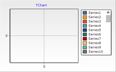

There's the Legend's MaxNumRows property for that.
I see it didn't work fine with v8 but it works fine with the actual version.
uses Series, TeeLegendScrollBar;
var Chart1: TChart;
var i: Integer;
  Chart1:=TChart.Create(Self);
  Chart1.Parent:=Self;
  Chart1.View3D:=false;
  for i:=1 to 50 do
    Chart1.AddSeries(TPointSeries);
  Chart1.Tools.Add(TLegendScrollBar);
  Chart1.Legend.MaxNumRows:=10;

Thanks, but when you say "actual" version do you mean "some version after 8.06"?
Happy Holidays!
Re: Set Max Rows/Series in Legend
Post by Yeray » Fri Dec 20, 2013 2:51 pm
Yes, I mean the latest, v2013.09.
Actually, I've also seen the property worked fine in v2010.00, the next release after v8.
Happy ones for you too! :)
