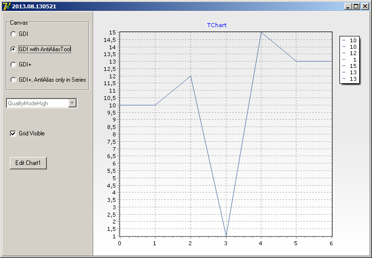

- TAntiAliasTool in v2013.08 gave an smoothed line, respecting the colors and with thin horizontal lines and grids:

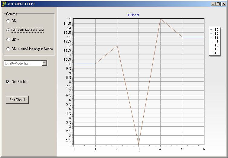

- In v2013.09, the TAntiAliasTool gives an smoothed line, with thin horizontal lines and grids, but breaking the colors:

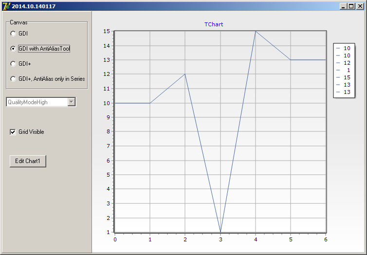

- In the actual sources. The TAntiAliasTool gives an smoothed line, respecting the colors, but with thick horizontal lines and grids:

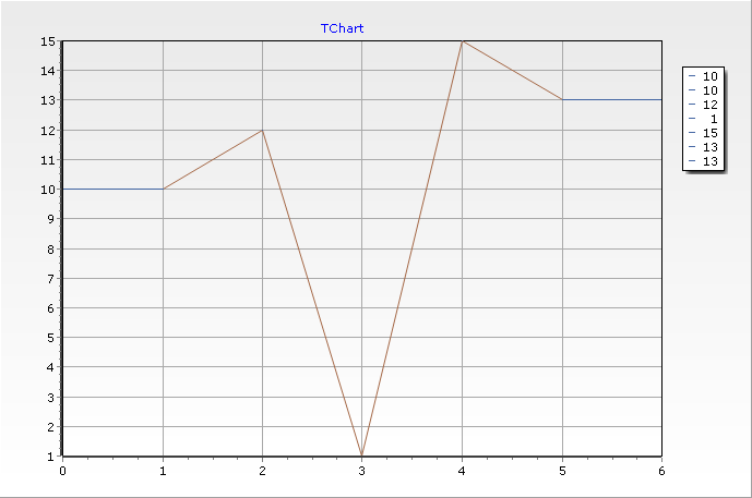

installed TeeChart 2014.10.140220 and added global project define: TEEANTIALIAS (and recompiled).
It works and reverts to use TAntialias canvas but the dualcolor bug is not fixed on TAntiAliasCanvas!

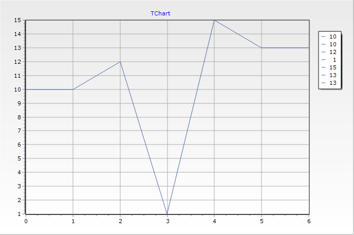

Re: TeeCanvas3d + Antialias drawing LineSeries dualcolor
Post by Yeray » Fri Feb 28, 2014 3:31 pm
Hi Janne,

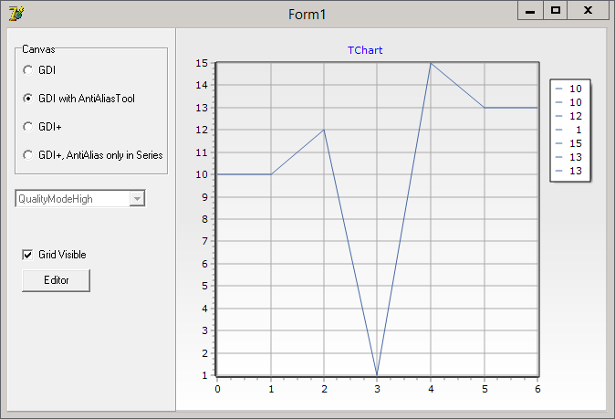

Just making sure the library path contains a reference to TeeChart v2014.10 installation lib path, and no other TeeChart path is in the library list, I open the project above, I build&run it and I get this:
Also, if you want to check what TeeChart version is used to build a project, you can output the TeeMsg_Version constant:
uses TeeConst;
  Caption:=TeeMsg_Version;
