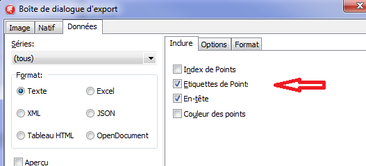

I've note 2 small glitchs in the french dialogs:
1) Checkbox size too small for translation

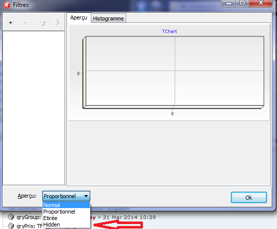

2) list box item not translated (in the filters dialog)
TeechartExportGlitch #1.png (46.6 KiB) Viewed 16349 times

zyma wrote:1) Checkbox size too small for translation
Corrected for the next maintenance release. Thanks for reporting it.
zyma wrote:2) list box item not translated (in the filters dialog)
You can declare set the HIDDEN variable as follows:
uses EditChar, TeeTranslate, TeeFrench, TeeConst;
  EditChart(Self, Chart1);
  TeeSetFrench;
  TeeFrenchLanguage.Text:=TeeFrenchLanguage.Text+'HIDDEN=Caché'+NewLine;

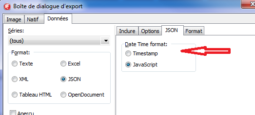

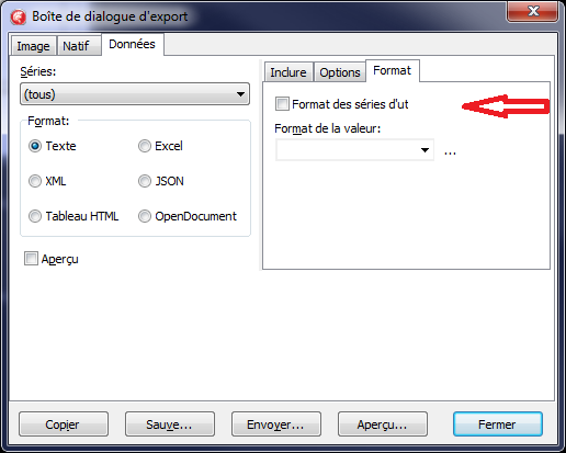

Found 2 other small glitches (one is size, the other is captions not translated.)
I've started comparing the units... what is the best way to process, I'll translate and fix my code to fit my immediate needs (I really need to release the software) , but what's next... can we except a complete fix soon... ???
TeechartExportGlitch #4.png (23.67 KiB) Viewed 16319 times
TeechartExportGlitch #3.png (24.49 KiB) Viewed 16317 times
I've set this label wider to fit it with the next maintenance release.
Add this to TeeFrench.pas:
'HIDDEN=Caché'+NewLine+
