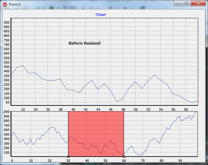

Post by elmec » Tue Dec 03, 2013 3:54 am
Before Resized
Project2.zip
Exe file
(87.93 KiB) Downloaded 1034 times

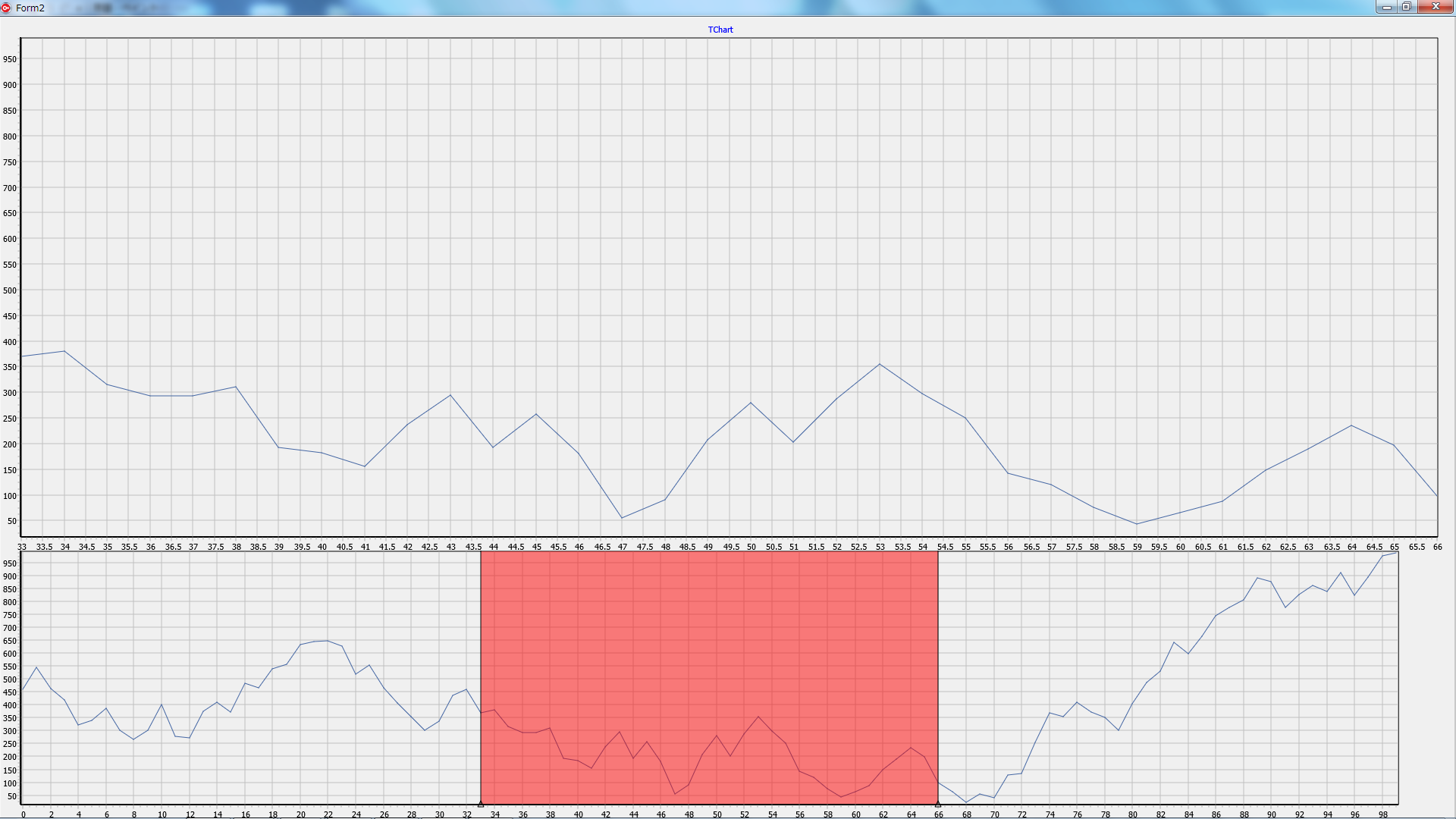

Please follow the following steps to reproduce the issue.
1). Change the StartValue and EndValue of TScrollPagerTool to the value instead of default,
2). Resize the TChart.
3). Click on the TChart.
I think you missed the step 1...

Post by elmec » Sun Jan 05, 2014 7:30 am
I think the problem is because of some event like _ColorBandChange_ not triggled,
so I checked the source of the TeeScrollPagerTool.pas..
and found that there is a procedure called ColorBandChanged..
then I added the code like the way of ColorBandChanged after
I assigned values to StartValue and EndValue...like the following..
And it seems that the problem is fixed..
	double start = ScrollPager->ColorBandTool->StartValue;
	double end   = ScrollPager->ColorBandTool->EndValue;
	ScrollPager->SetUpScrollPager();
	ScrollPager->ColorBandTool->Color      = claGray;
	ScrollPager->ColorBandTool->StartValue = start ;
	ScrollPager->ColorBandTool->EndValue   = end;
	Chart->BottomAxis->SetMinMax(start, end);
