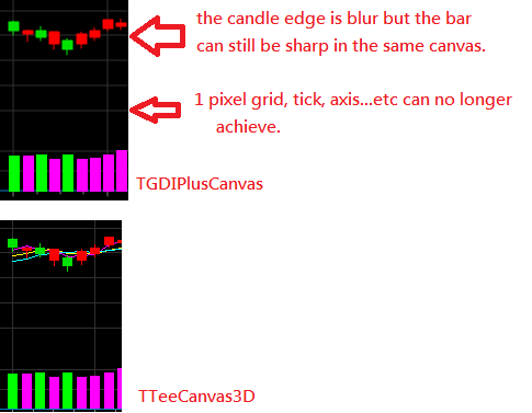

I'm trying to upgrade my project from TTeeCanvas3D to TGDIPlusCanvas for more eye candy.
Currently there are 2 noticeable differences that I'd like to ask for advice.
1. How can I have a sharp TCandleSeries in TGDIPlusCanvas? just like TBarSeries does. They are all about rectangle and straight line after all.
2. 1 pixel setting is not presenting any more. Can I have it back? they are all straight lines though.

The question 1 is more important because it actually makes visual comparison of OHLC prices more harder for our customers.

Hi sswang,
Yes, this is possible disabling GDI+ canvas AntiAlias property, for example:
  (GDIPChart.Canvas as TGDIPlusCanvas).AntiAlias:=False;
A complete example comparing identical charts in GDI+ and GDI Win32:

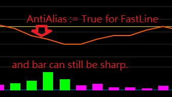

How can I make TCandleSeries to be as sharp as TBarSeries does while AntiAlias:=True?
Re: Some questions about TGDIPlusCanvas
Post by Narcís » Mon Dec 02, 2013 11:16 am
You can disable AntiAlias por TCandleSeries only, for example:
procedure TForm1.Series1BeforeDrawValues(Sender: TObject);
  (Chart1.Canvas as TGDIPlusCanvas).AntiAlias:=False;
procedure TForm1.Series1AfterDrawValues(Sender: TObject);
  (Chart1.Canvas as TGDIPlusCanvas).AntiAlias:=True;
The complete example:

sswang
Posts: 24
Joined: Wed Mar 28, 2012 12:00 am
Post by sswang » Tue Dec 03, 2013 7:22 am
This is really helpful, thanks!
