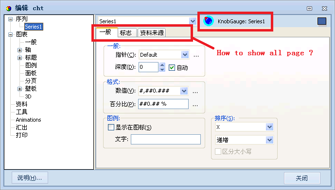

This picture is the screen shot at runtime, how to show all edit page ?
Re: About KnobGauge
Adding TeeEditPro to your uses list solves the problem:
TeeEditPro unit registers all series classes.
uses TeeEditPro;
ChartEditor1.Execute;

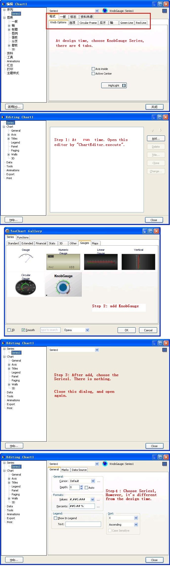

I want to know how to show the editor at runtime as design time.
Screen shots :

This works fine for me here using latest TeeChart version, published last week. Which Delphi and TeeChart versions are you using?

TeeChart Pro v2013.08.130521 32bit VCL
Delphi 2007
Delphi 2007
Re: About KnobGauge
Please try with TeeChart Pro v2013.09.131119. Does this solve the problem for you?

As you said, it work well now.
thks.
