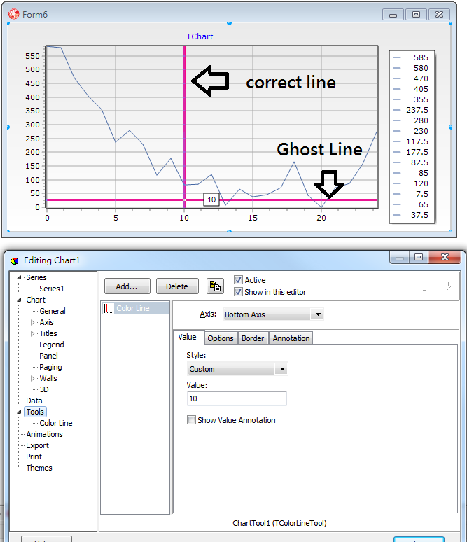

TColorLineTool and TFastLineSeries are heavily used in my project.
There is an extra horizontal "Ghost" line the chart if I set TColorLineTool's axis to bottom,
and there will be no line if I set axis to right.
Please help! thanks.

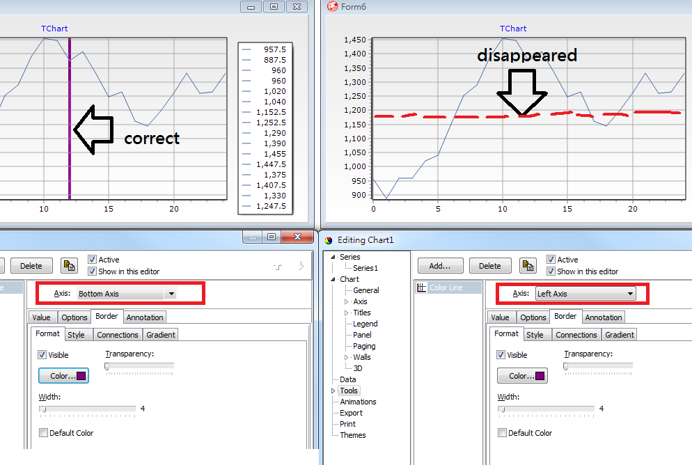

I've checked the fix and found that vertical line problem is solved, but horizontal line does not appear.
Please check the attached picture for detail, Thanks.

Thanks for your feedback. I reopened the issue: http://bugs.teechart.net/show_bug.cgi?id=465#c2
Re: Strange behavior with TColorLineTool...
Post by Narcís » Mon Nov 25, 2013 2:38 pm
This has just been fixed and sent you updated TeeTools.pas

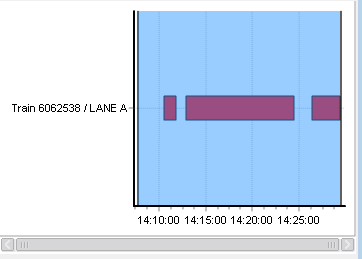

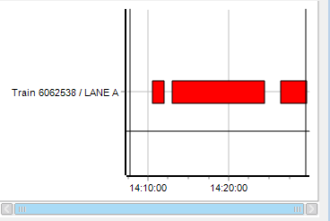

Post by RA Team » Wed Jan 08, 2014 12:38 pm
Upgrading from Delphi 7 TeeChart 6 pro to Delphi XE2 latest TeeChart pro - experiencing same issue in our application with TcolourLineTool and TColourBandTool - this worked find in the evaluation copy (v2013.08.130521) see below TeeChartEval.png but in professional version see TeeChartProfessional.png - significantly different - please help
