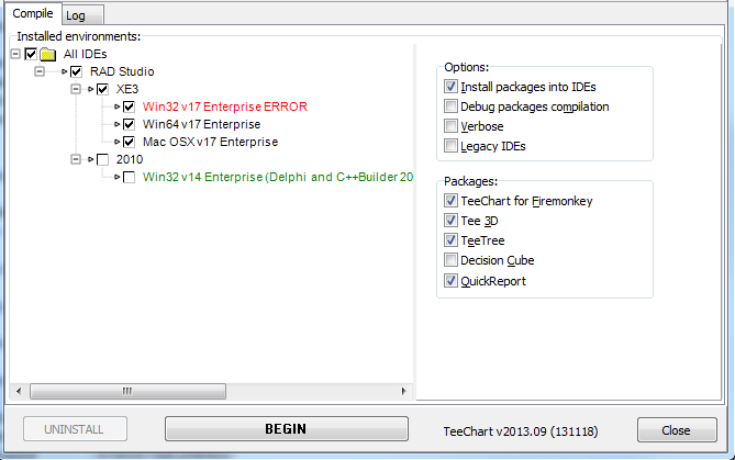

Teechart pro with source D2010 has been successfully installed in my conputer, but XE3 failed.
A partial copy of install log is here, please help.
TeeChart Installation
VERSION: 2013
Installing...
Win32 v14 Enterprise (Delphi and C++Builder 2010 Update 5 (Database Pack)) (2010 Update 4) OK. Time: 25s
Win32 v17 Enterprise
Tee917
Cannot recompile Delphi package: Tee917.dpk
Embarcadero Delphi for Win32 compiler version 24.0
Copyright (c) 1983,2012 Embarcadero Technologies, Inc.
VCLTee.TeeConst.pas(594) Error: E2066 Missing operator or semicolon
VCLTee.TeeConst.pas(594) Error: E2052 Unterminated string
VCLTee.TeeConst.pas(1012) Error: E2052 Unterminated string
VCLTee.TeeConst.pas(594) Fatal: E2280 Unterminated conditional directive
EXCEPTION:
Compilation aborted.
Cannot install latest VCL version under XE3

Hi sswang,
Could you please reinstall TeeChart sources and try again? Probably that file has been corrupted during the installation. You could keep a "clean" sources copy just in case this occurs so that you can overwrite modified sources easily.
