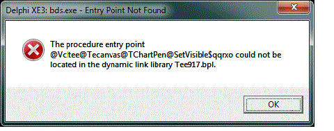

Prior to install I uninstalled the previous version and rebooted then installed the latest TeeChart 2013.09.131119 VCL/FMX for Delphi XE3 Ultimate.
All seemed to go well until I started Delphi and attempted to load up an existing project which contains some basic TeeCharts.
I received the error dialogue stating
bds.exe - Entry Point Not Found
The procedure entry point
@vcltee@Tecanvas@TChartPen@SetVisible$qqrxo could not be located in the dynamic link library Tee917.bpl
Please can you advise how to resolve this problem.
Many thanks
Rob

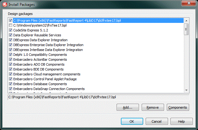

Sorry this does not fix the problem, when I click on Install Packages I get the dialogue below.
Install Packages.gif (64.61 KiB) Viewed 5628 times
Then when I try to select the unticked checkbox against c:\Windows\system32\frxTee17.bpl

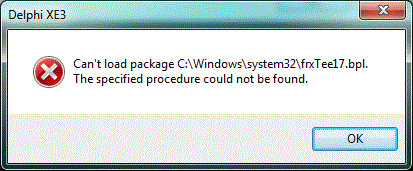

When I click on OK I get
Cannot Load package c:\Windows\system32\frxTee17.bpl
The specified procedure could not be found.
Specified procedure cannot be found.gif (18.39 KiB) Viewed 5640 times
I am running Windows 7 Pro 64bit Delphi XE3 Ultimate with all available patches, and also running FastReports 4.15 for VCL.
Re: vcltee@Tecanvas@Tchartpen@SetVisible$qqrxo error
Post by Narcís » Wed Nov 20, 2013 3:43 pm
This for the Fast Reports packages for TeeChart I guess. The problem might be that FastReports packages that are still using the old TeeChart versions. You could try disabling them and enabling new TeeChart packages. If that works then you should consider updating your FastReports for TeeChart components to your current TeeChart version. You could ask FastReports for packages compatible with your TeeChart version or, if you have FastReports sources, do something similar to what's explained in the QuickReport article.
