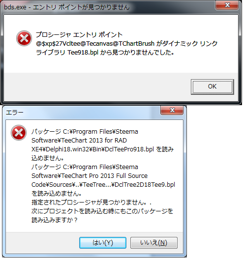

(2) Start RAD XE4 then error arose. (Find attachment 1)
(3)Close RAD XE4, uninstall and reinstall...
(4)Start RAD XE4, the same error with (2)

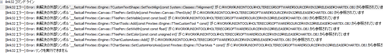

(5)Ignore the errors and recompile my project, get the link errors (Find attachment 2)

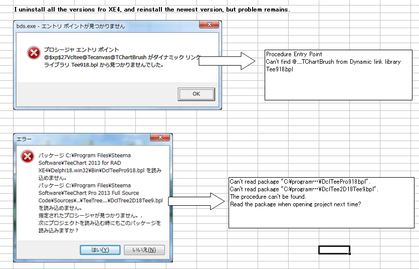

I uninstall all the versions fro XE4, and reinstall the newest version, but problem remains.
- Install.png (126.68 KiB) Viewed 14291 times

Ok, thanks. Go to Component -> Install Packages and check that new TeeChart packages are enabled on the list.

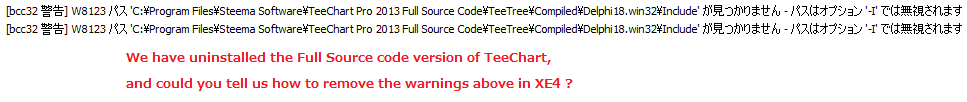

And would you pls tell us how to solve the following problem?
No, errors remains..
- warning.png (10.17 KiB) Viewed 14211 times

As far as the warning messages in your last post, could you please translate them for us?
