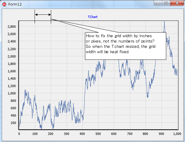

How to fix the grid width by inches or pixels, not the numbers of points?
So when the Tchart resized, the grid width will be kept fixed.
Grid Width by Pixels.png (67.16 KiB) Viewed 6328 times

You could calculate the axis range (Maximum minus Minimum) and then divide it for the number of grid lines you'd like to get and set Increment property accordingly.

I meant that how to fix the grid width without changing Increment
when TChart resized.

Use custom labels instead then. You'll find an example at All Features\Welcome!\Axes\Labels\Custom Labels in the features demo.
