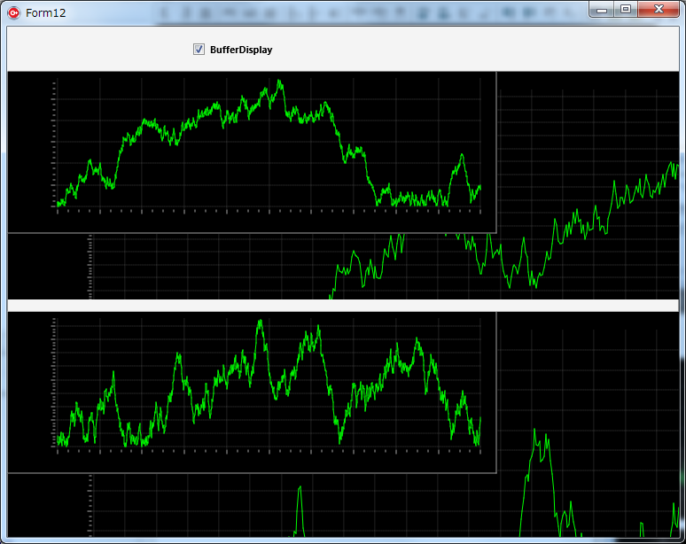

TChart with Align property set as alScale can't be drawed
automatically when BufferDisplay property set as TRUE..
Find attachment for example project.
The screenshot when form resized

Hi elmec,
Enabling BufferedDisplay and resizing the form doesn't show the problem here using our internal sources. So you may expect this being fixed for the upcoming maintenance release, which we expect to publish very soon.
