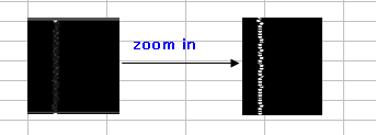

There is no Horizontal Point Line,
so I using the Horizontal Line, and set the Pointer as visible,
change the transparency to 100 to hide the line between pointer
to make it look like as pointer series.
But just like shown in the attachment,
when there are a lot of points ,
they are drawed overlaping each other, so cannt be shown clearly.
When I zoom in the series, it became clearly drawed.
Do you have any ideas to draw all the pointer in like some "Merge" mode?

elmec wrote: Do you have any ideas to draw all the pointer in like some "Merge" mode?
Yes, you can do as in the All Features\Welcome\Functions\Extended\Reducing number of points example in the features demo, which uses TDownSampling function. Demo can be found at TeeChart's program group.

You can either set pointer style to small dots:
  Series1.Pointer.Style:=psSmallDot;
Or make pointers smaller:
  Series1.Pointer.VertSize:=1;
  Series1.Pointer.HorizSize:=1;

The attachment I have attached was the result after
So, I tried to
but all of the points diappeared...
BTW, I am using XE4 Firemonkey HD APP.
