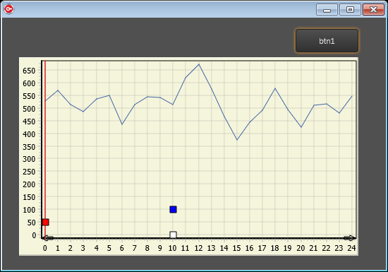

the attachment for ValueColor Index problem

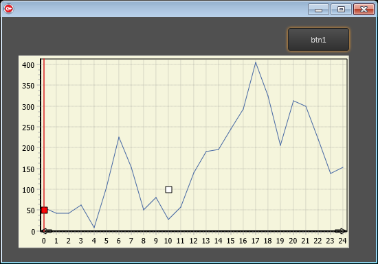

Post by elmec » Thu Nov 07, 2013 1:40 am
When I change
	Series2->AddXY(0, 50, "", claRed);
	Series2->AddXY(10, 100, "", claBlue);
	Series2->ValueColor[10] = claWhite;
to
	Series2->ValueColor[9] = claWhite;
It looks working well. Why?

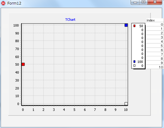

If you use an invalid index it adds sequential values up to this point with Y value being 0.
As shown in the attachment, the legend is showing that
there are 11 points (from 0 to 10),
and the 10th point (index=9) is 100(blue point),
but why it is shown at the index of 10 in chart?

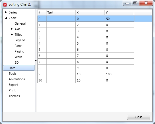

Re: ValueColor Index problem
Post by Narcís » Mon Nov 11, 2013 12:16 pm
Hi elmec,
An image will be more helpful to explain it. Look at the Data tab in the chart editor for your chart:
In your code you start adding two points: X=0 and X=10. Then, you modify the 11th point in the series (index 10), this creates missing sequential points starting at 2 since there are 2 existing points in the series. TeeChart counts the number of points that will be necessary, 9 points, and adds them with Y=0. Hence points with indices: 2, 3, 4, 5 ,6, 7, and 10, are added. You change the color of the 11th point (X=10, Y=0 and Color=White) but it is also plot at 10 due to the sequential index generated.
