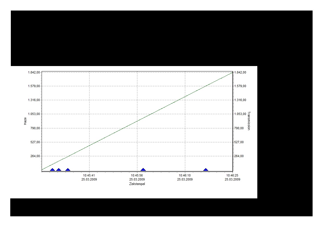

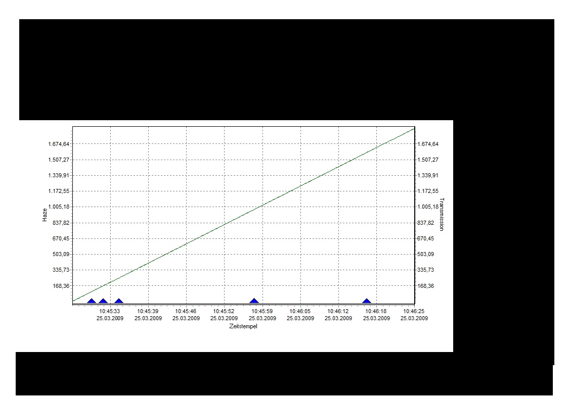

This works very well most of the time, but sometimes the vertical axis labels are messed up (see attachment broken.jpg). After some investigation I figured the printout depends on the state of the MDI child window. When the application (and the MDI child frame) is visible the printout looks like the attachment normal.jpg. When the application is minimized to the taskbar the printout looks like the attachment hidden.jpg. In rare cases the printout looks like attachment broken.jpg, but that happened only if the main application was minimized.
I don´t understand how a TQRChart component renders the chart, I was under the impression the TQRChart´s size depends solely on the TQRChart´s size on the TQuickRep. Since we use a fixed page and paper size the printout should always look the same. How come the printout looks different, depending on the state of the corresponding MDI child window. Why do the printouts normal.jpg and hidden.jpg look different? Is this intended, and, if not, how can I fix it?

- Messed up printout
- Broken.jpg (101.83 KiB) Viewed 16721 times
- Printout generated when visible
- Normal.jpg (116.01 KiB) Viewed 16662 times
- Printout generated when minimized
- Hidden.jpg (84.87 KiB) Viewed 16629 times
