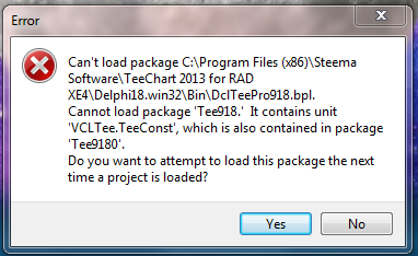

Good morning I have a problem when I install the application tee chart 2013 for RAD studio everything goes fine but when I open the Delphi environment there appears an error. the error is in attachment. and the components are not reacheable.

This error message indicates that TeeChart Standard packages shipped with XE4 are still being referenced. Same issue was discussed here.
