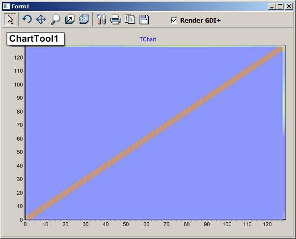

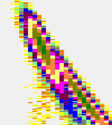

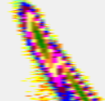

Why TColorGridSeries has has great difference for GDI and GDI+ render?
This can be seen in attachments.
- GDI+Render.png (76.82 KiB) Viewed 23777 times
- GDI_Render.png (4.15 KiB) Viewed 23759 times
With best regards
Vladimir

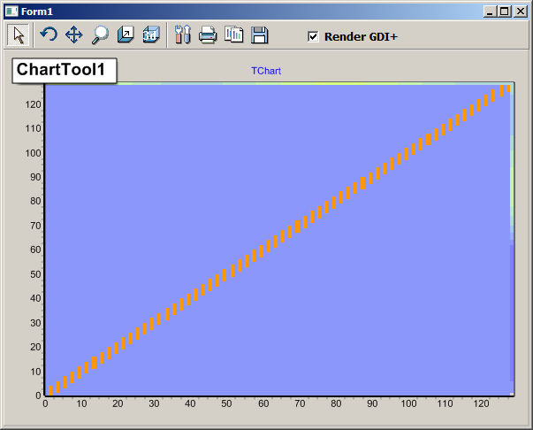

Re: TcolorGridSeries: GDI & GDI+ difference
Hi Vladimir,
I've tested this with XE5 and the latest beta version (130911) publicly available here and the actual internal sources we have here. I could reproduce the problem with your application and the beta; however I can't test it with the internal version so I made a Delphi version of the same application. This delphi version seems to reproduce the problem with the beta and not with the actual sources, so I'd expect this to be fixed with the next maintenance release.
