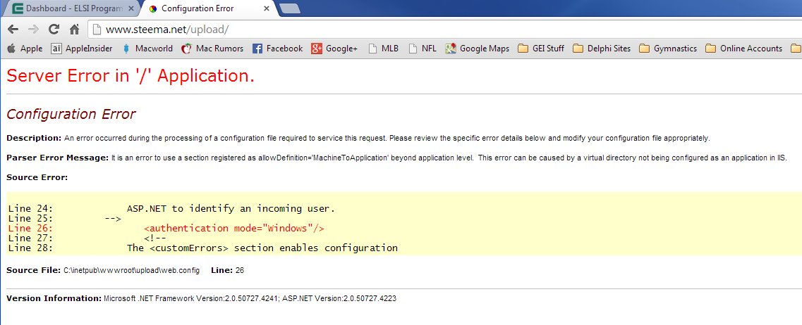

Here is the error I get when I try to use the upload page. I'm using Chrome browser.

sevenout wrote:Here is the error I get when I try to use the upload page.
Thanks for your feedback. The upload page has been fixed now.
