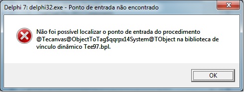

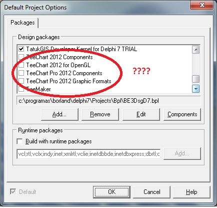

I have problems to install Teechart2013 in Delphi 7.
I clean old references to Teechart (include registers with regedit).

Please, close the IDE and run TeeInstall twice: the first is to uninstall the component and the second to reinstall it to the IDE).
If the second time you run it, it still says it is going to uninstall the component, it's probably that the uninstaller is failing to uninstall some of the packages. In that case, please remove it manually from the list, close the IDE and run TeeInstall again so it can install the components.
Then, check the packages list. If you still can't activate the components, don't hesitate to let us know.

I tried several times (reinstalling TeeChart2013SourceCode.exe and executing TeeRecompile.exe). The problem persists.

A new machine, a new OS, a new D7 installation...
The first component for installation: Teechart2013...
And nothing!

That's strange. What exact OS are you using? Is it 32/64bit?
And make sure you have enough privileges when you run TeeRecompile (run as admin).
