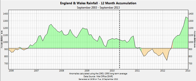

I'm using a THighLowSeries component to show values of two diffrent colors. If its above a certain threshold then its one color if its below its another. The trouble is that the series does not mark the boundary when the line intersects with the horizontal threshold value correctly and the colors are out of alignment (see attachment).
Is there anything I can do to correct this?
I did try adding another THighLowSeries series and use one for above the threshold and one for below the threshold but ran into the same problem.

Before I write a demo project perhaps you can say what I'm doing in code is actually causing the problem?
Here is the snippet that produces the screen shot I already sent you.
The parts of the graph that are above the mean are green but orange if they fall under the mean.
Let me know if you have any idea - if not I'll put together a demo.
Bruce.
const
accumulation = array[0..5] of double = (960,880,895,950,860,900);
mean = 905;
var
idx : integer;
for idx:=0 to 5 do
if accumulation[idx]>mean then
Series1.AddHighLow(idx,accumulation[idx],mean,'',clLime)
Series1.AddHighLow(idx,mean,accumulation[idx],'',clWebOrange);
Bruce.
