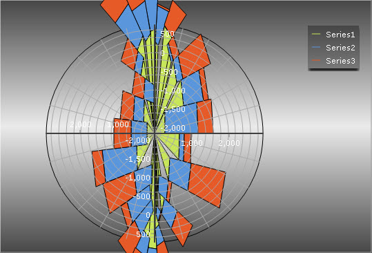

I would like to zoom in on a Rose Chart but when I zoom in using the mouse wheel chart only zooms on one axis, is there any way to force it to do this correctly and also clip the rose to the bounds of the circle?

The same problem also occurs in the TeeChart Pro Examples app, just scroll your mouse wheel over the rose chart...
I am using Build 2013.08.130521
Sean.

Thanks for your feedback. I could reproduce the issue here and added it (TV52016726) to the defect list to be implemented in future releases.
You can clip the rose to the chart rectangle bounds like this:
procedure TForm2.Series1AfterDrawValues(Sender: TObject);
  Chart1.Canvas.UnClipRectangle;
procedure TForm2.Series1BeforeDrawValues(Sender: TObject);
  Chart1.Canvas.ClipRectangle(Chart1.ChartRect);

As an update, setting TChart.ClipPoints to true already clips the series, for example:
  Chart1.ClipPoints:=True;
