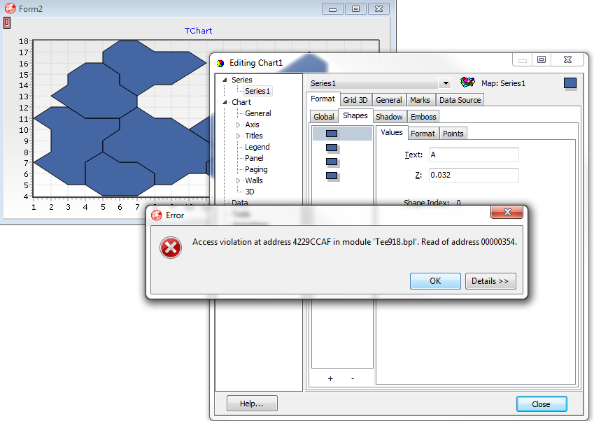

I am trying to draw polygons in a TChart and encountered some issues with the MapSeries.
First, I do not quite understand how to draw polygons at all. The functions seem to have changed recently, because browsing the forums did not yield any results for me. The included HTML help file was not useful to me either.
I would appreciate it if you could show me a sample source code where you create a map series and draw some simple shape, a triangle perhaps.
The second issue i found is, that when creating a map series with the editor, trying to access the Shapes Tab in the parent tab "Format" causes access violations - as many as there are polygons, I think.
I am using TeeChart Pro v2013.08.130521 32bit VCL in Delphi XE4.
I hope you can help me on that matter.
If no quick solution for the issue can be found, it would be nice if you could show me an alternative to polygon drawing.
Best regards
screenshot with AV
06-09-2013 14-02-29.png (69.99 KiB) Viewed 7022 times

BHinnoForce wrote:The second issue i found is, that when creating a map series with the editor, trying to access the Shapes Tab in the parent tab "Format" causes access violations - as many as there are polygons, I think.
I get a similar error with the same code above and the last TeeChart v2013.08, but not with the actual sources that would be used for the next maintenance release.
I've just added an TChartEditor to the example above:
  private
    { Private declarations }
    procedure Chart1DblClick(Sender: TObject);
uses {...}, TeeEdit, TeeMapSeriesEdit;
  Chart1.OnDblClick:=Chart1DblClick;
procedure TForm1.Chart1DblClick(Sender: TObject);
  with TChartEditor.Create(Self) do
    Chart:=Chart1;
    Execute;
