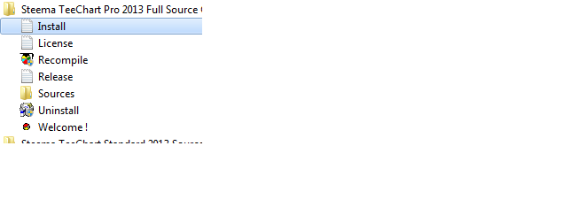

Hi.
I can not find the features demo.
It is not located under the TeeChart's program group.

Re: Barseries, overlapping bars
Hi JohnA,
That's the source code version. Demos, tutorials and documentation ares only included with the binary installers to keep the source code version as small as possible. Moreover, source code customers also have access to the binary installers. We recommend to install them prior to the source code version to have access to those resources.

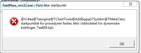

Hi.
I uninstalled with source code
Installed binary
installed with source code and recompiled.
When I'm starting the new features demo I get this error.
Installed binary
- Skjermbilde.PNG (16.8 KiB) Viewed 10217 times
In case you do not understand norwegian
roughly translated to "Procedure Entry Point did not exist in the dynamic link library"
Hi JohnA,
That's probably because the .bpl it was compiled with no longer exists as it was overwritten by the source code generated package. In that case you should open the demo project (Tee9New.dpr) at C:\Program Files\Steema Software\TeeChart 2013 for RAD XE4\Examples\Features, for example, and compile it with your current TeeChart version.
