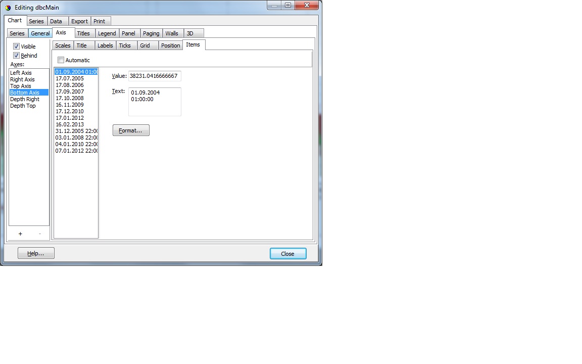

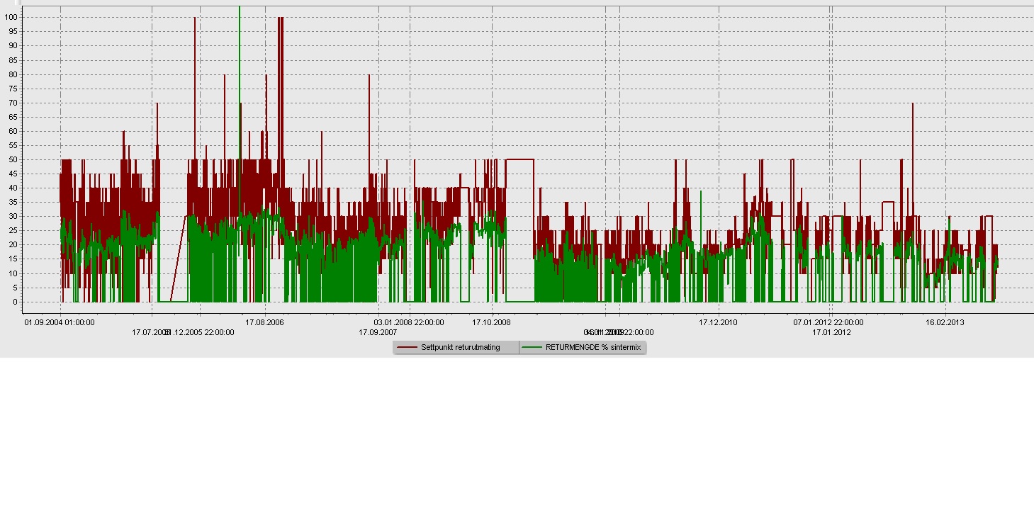

I have a problem with overlapping x-axis labels in a set of manual series in a TDBChart (latest version).
This is a problem that came with an upgrade of a project from Delphi 7 to Delphi XE2.
It was not an issue in Delphi 7.
I've tried to manipulate the bottomaxis label items.
If they are being sorted correctly, the problem seems to be solved.
But I can't figure out how to sort this list.
Do anyone have an example of how to sort this list?
List of items in the x-axis labels
