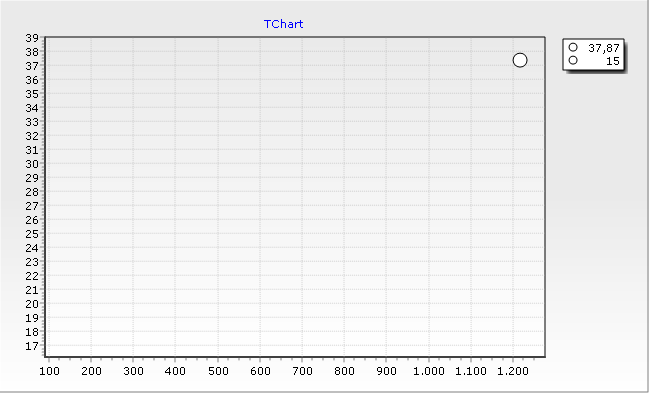

I get this:

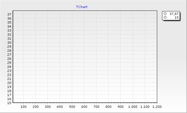

If I scroll the chart a bit to the down-left, I see the shape:
So, as you say, the axes seem to be wrongly scaled.

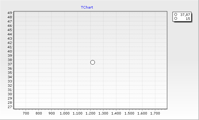

You can centre the shape with this:
uses TeeShape;
var tmp: Double;
  Chart1.View3D:=false;
  with Chart1.AddSeries(TChartShape) as TChartShape do
    XYStyle:=xysAxisOrigin;
    X0:=1200;
    Y0:=37.87;
    X1:=15;
    Y1:=15;
  Chart1.Draw;
  with Chart1.Axes.Left do
    tmp:=(Maximum-Minimum)/2;
    SetMinMax(Minimum+tmp, Maximum+tmp);
  with Chart1.Axes.Bottom do
