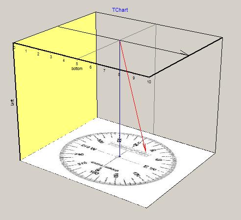

I now have a start to what I need. I setup a 3D TeeChart with each axis set to 0 to 10. I added an image of a compass rose on the bottom axis. I plot a vector from the center of the top (5,10,5) to the positions given to me by the sensor (see the image below). The vector the represents the direction and dip of the probe. This works but I have a few problems still. 1) I would like to increase the line thickness of the probe vector (red) but I don't find anyway to do this. 2) I would like to draw to lines across the two top axes - to define the starting point of the vector. In the image I made the top front -to-back center line using a grid line for the axis (is there a way to show the grid lines without the axis values?). I cannot find a way to setup an axis grid line to make the top right-to-left line. For now I used a second vector line to make the top right-to-left line. It looks a bit funny because it has an associated arrow head (I cannot find a way to hide the arrow head either).
Any suggestion on how to make the vector line thicker (or thicker and wider); how to draw the top center lines or how to remove the vector arrow head would be appreciated.

- 3D chart using a vector to show probe orientation on compass rose.
- 3D plot1.jpg (25.21 KiB) Viewed 13433 times

How are you drawing it? Custom drawing on the chart canvas or using a built-in series? Most likely you need to change the Pen.Width of the object you use, for example:1) I would like to increase the line thickness of the probe vector (red) but I don't find anyway to do this.
Chart1.Canvas.Pen.Width:=3;
I'm afraid not. There's a trick you can do though, you can make blank spaced labels so that grid lines are drawn and labels are not visible and also modify Ticks and MinorTicks, for example:2) I would like to draw to lines across the two top axes - to define the starting point of the vector. In the image I made the top front -to-back center line using a grid line for the axis (is there a way to show the grid lines without the axis values?).
procedure TForm2.Chart1GetAxisLabel(Sender: TChartAxis; Series: TChartSeries;
ValueIndex: Integer; var LabelText: string);
if Sender = Chart1.Axes.Left then
LabelText:=' ';
Chart1.Axes.Left.TickLength:=0;
Chart1.Axes.Left.MinorTicks.Visible:=False;
You may need to make the DepthTop axis visible:I cannot find a way to setup an axis grid line to make the top right-to-left line. For now I used a second vector line to make the top right-to-left line.
Chart1.Axes.DepthTop.Visible:=True;
Changing Pen.Width as I suggested earlier. If this doesn't help please attach a simple example project we can run "as-is" to reproduce the problem here.Any suggestion on how to make the vector line thicker (or thicker and wider);
Using DepthTop axis.how to draw the top center lines or how to remove the vector arrow head would be appreciated.

Thanks for the impressively fast response! I originally used the Vector 3D series to draw the “probe position” and I did not find a line thickness for this series. Changing the pen width for the series did make the probe’s vector arrow thicker. Thanks for the idea.
I eventually changed to use the TPoint3DSeries. When the line is thick it makes a nice looking cylinder (a good representation of the probe).
I tried to use the DepthTop axis and grid to make the Left-right top center line (to define the start of the vector) but I cannot make it work. The DepthTop grid is shown on the yellow wall and the bottom compass image. The DepthTop grid seems to grid the same walls as the DepthRight grid. I cannot find a way to show a grid that covers the top of the chart “cube”. I ending up using MoveTo3D and MoveTo3D to draw the “grid” line. Works great!

I see, grid lines for the DepthTop axis are painted on the left wall. Glad to see you found a workaround.Robert Yeatman wrote: I tried to use the DepthTop axis and grid to make the Left-right top center line (to define the start of the vector) but I cannot make it work. The DepthTop grid is shown on the yellow wall and the bottom compass image. The DepthTop grid seems to grid the same walls as the DepthRight grid. I cannot find a way to show a grid that covers the top of the chart “cube”. I ending up using MoveTo3D and MoveTo3D to draw the “grid” line. Works great!
