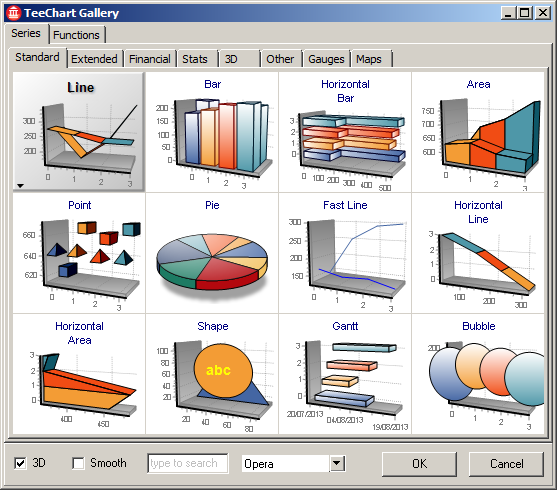

Steve Maughan wrote:I right clicked and selected options and then the "Chart Gallery" tab. It says the chart is being rendered as GDI, but from the anti-aliasing it must be GDI+ (unless there is some sort of GDI anti-aliasing going on).
This option is to change it for the charts that are created to show the Series Gallery:
However, I see this option doesn't take effect. We'll try to fix in for next releases (TV52016653).

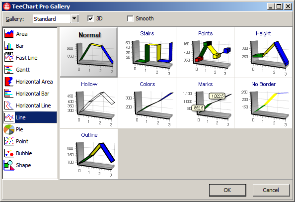

Steve Maughan wrote: Also what does Mode do (Normal and Alternate) do?
Alternate mode activates the new series gallery "alternate" mode, that looks different:
