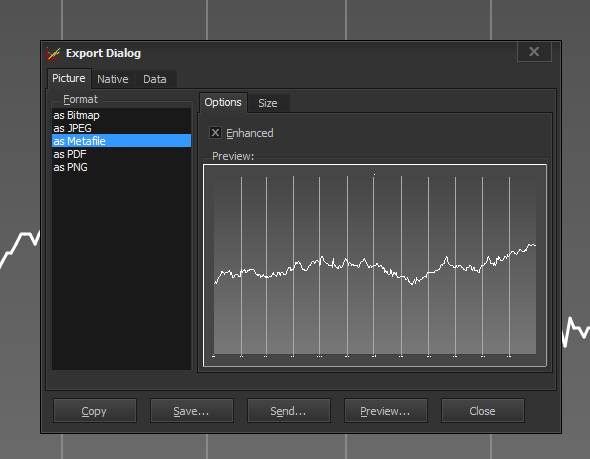

I am using the Export functionality. I am not using the editor, I am actually calling the function " TeeExport(Self,Chart1);
How can I hide the Natiev and The Data taps ? I am uploading a screen shot

You can use this instead of TeeExport:
  With TTeeExportForm.Create(Self) do
  try
    ExportPanel:=Chart1;
    InitDir:='';
    TabData.TabVisible:=false;
    TabNative.TabVisible:=false;
    ShowModal;
  finally
    Free;
