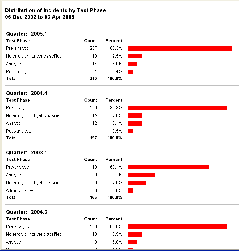

Thank you, again! That does compile, but the charts still appear in an un-sorted order, as can be seen in the attached screen shot. I would like the Quarters to ascend uniformly

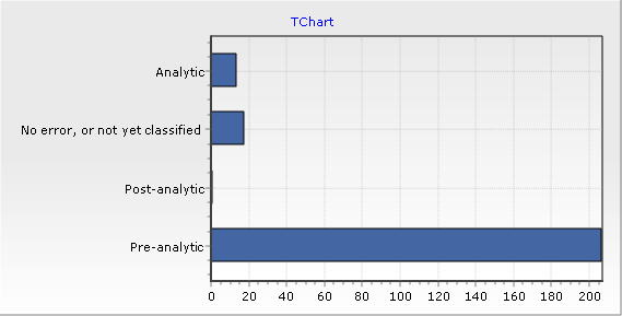

I'm not sure if this is how you are creating your charts:
  Chart1.View3D:=false;
  Chart1.Legend.Visible:=false;
  with Chart1.AddSeries(THorizBarSeries) as THorizBarSeries do
    Marks.Visible:=false;
    Add(1, 'Post-analytic');
    Add(14, 'Analytic');
    Add(18, 'No error, or not yet classified');
    Add(207, 'Pre-analytic');
    //SortByLabels(loDescending);
With the above, I get this:

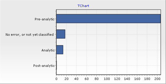

Then, if I uncomment the SortByLabels(loDescending) line in the code above, this is what I get:
Isn't it how it behaves for you?

I am not trying to change the order of the bars within the charts. I am trying to change the order of the charts on the page.
The current order is
Quarter: 2005.1
Quarter: 2004.4
Quarter: 2003.1
Quarter: 2004.3
This order makes it difficult to find a particular chart, because the order appears to be random.
I imagine that the charts are in this order because they are sorted by Total Count, but I want the option of sorting them by their labels (Quarter: 2005.1)
