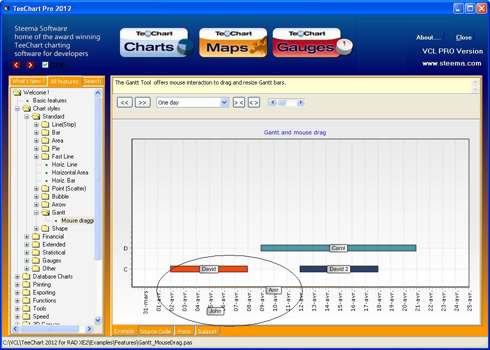

Also, another point interesting, also visible on the same demo page you suggested:
if you drag the whole chart to the bottom, they disappear from the display area after they pass the bottom axis, but surprisingly, the labels are not!
How can i force the labels (marks) to disappear?
I join a snapshot for this point (please look inside the ellipse at the bottom).
Merci
Laurent
Merci
Laurent
- Connected to the second point
- Gantt_lables.JPG (117.38 KiB) Viewed 7084 times

Re: Gantt chart and paging
Hi Laurent,
If you are using GDIPlus you may also have to hide the marks shadow, setting Marks.Shadow.Visible to false.
Try setting Marks.Clip to true.AB Prod wrote:Also, another point interesting, also visible on the same demo page you suggested:
wonderful no more marks under the line axis!
Great, tnx a lot
Laurent
