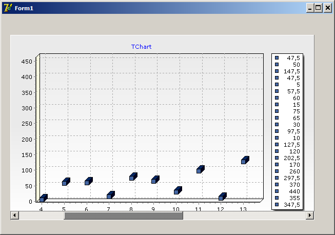

But when I mouse over the scrollbar, It generate a fading animation,
but the image that it captured for fading is from the top portion of chart, which is wrong bescause
the scrollbar is actually on the bottom, so the result is weird.

I'm using the following code:
uses Series, TeeScroB;
var FChartScrollBar: TChartScrollBar;
  Chart1.AddSeries(TPointSeries).FillSampleValues;
  Chart1.Axes.Bottom.SetMinMax(0, 10);
  FChartScrollBar := TChartScrollBar.Create(Chart1);
  FChartScrollBar.Parent := Chart1;
  FChartScrollBar.Chart := Chart1;
  FChartScrollBar.Align := alBottom;
And I see the animation just on the bar with Delphi 7. What IDE are you using?
Have you tried with a regular TScrollBar?
