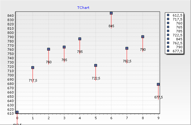

I understand you have something like this, isn't it?
uses Series;
  Chart1.View3D:=false;
  with Chart1.AddSeries(TPointSeries) do
    FillSampleValues(10);
    Marks.Visible:=true;
    Marks.Callout.Length:=-50;
    Marks.Arrow.Color:=clRed;
    Marks.Transparent:=true;
In that case, what you could do is to manually set the marks ArrowTo.Y positions as in the following example:
var i: Integer;
    tmpPos: TseriesMarkPosition;
  Chart1.Draw;
  with Chart1[0] as TPointSeries do
    for i:=0 to Count-1 do
      tmpPos:=Marks.Positions.Position[i];
      tmpPos.Custom:=true;
      tmpPos.ArrowTo.Y:=tmpPos.LeftTop.Y;

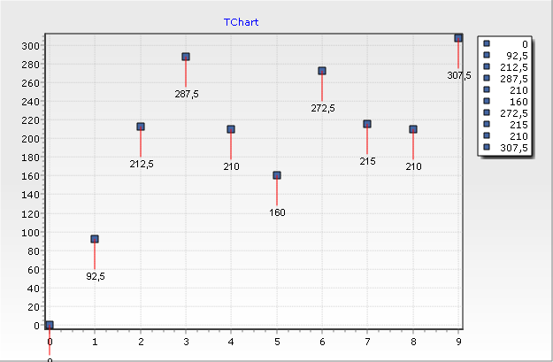

Re: TLineSeries Marks Arrows go through callout.
Post by Yeray » Thu May 16, 2013 4:13 pm
What about this? I've made it with TeeChart v7 and Delphi 7.
  private
    { Private declarations }
    procedure CalcMarks;
uses Series;
  CalcMarks;
procedure TForm1.CalcMarks;
var i: Integer;
  Chart1.Draw;
      tmpPos.ArrowFrom.X:=GetHorizAxis.CalcPosValue(XValues[i]);
      tmpPos.ArrowFrom.Y:=GetVertAxis.CalcPosValue(YValues[i]);
      tmpPos.ArrowTo.X:=tmpPos.ArrowFrom.X;
      tmpPos.ArrowTo.Y:=tmpPos.ArrowFrom.Y-Marks.Callout.Length-tmpPos.Height;
      tmpPos.LeftTop.X:=tmpPos.ArrowFrom.X-(tmpPos.Width div 2);
      tmpPos.LeftTop.Y:=tmpPos.ArrowTo.Y;
procedure TForm1.Chart1Scroll(Sender: TObject);
  CalcMarks;
procedure TForm1.Chart1UndoZoom(Sender: TObject);
  CalcMarks;
procedure TForm1.Chart1Zoom(Sender: TObject);
  CalcMarks;
