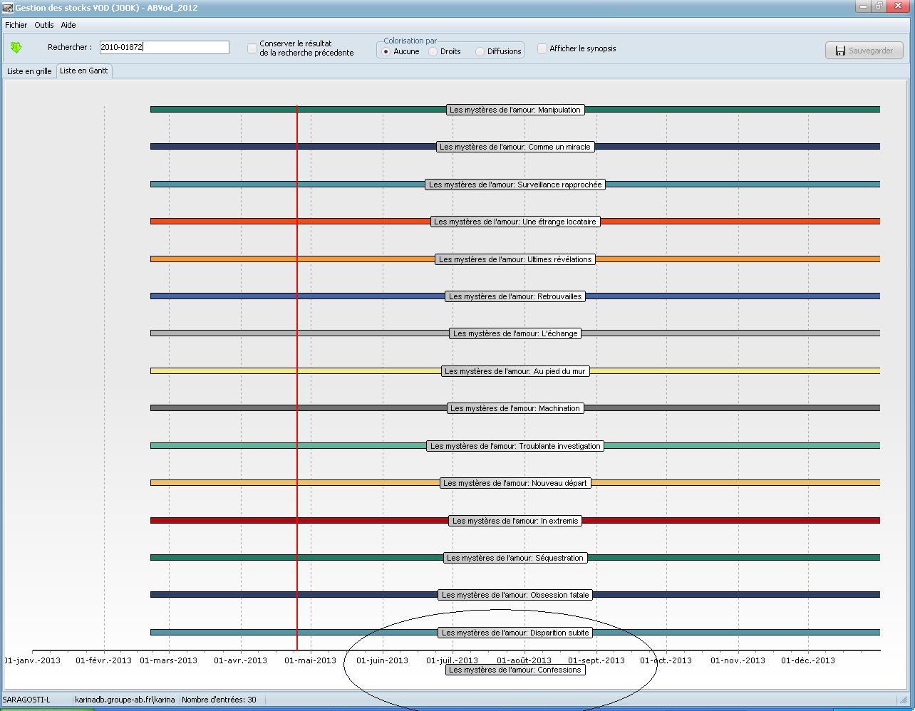

1. How can i force the drawing of the Gantt so it will not be displayed under the bottom axis Or on it (Only up)?

I'm not sure to understand what do you exactly mean. Could you please attach some screenshot or image showing it?AB Prod wrote:1. How can i force the drawing of the Gantt so it will not be displayed under the bottom axis Or on it (Only up)?
You should play with the axes scale for this. When the scale is automatic, the minimum and maximum are internally calculated to fit the values that are going to be drawn. Knowing the values that can be drawn, you can set the appropriate stale manually with SetMinMax function.AB Prod wrote:2. Which property do i need to use in order to control the spacing between each Gantt object? Sometimes i will draw 3 objects, other times it can be 20 or more, so esthetically speaking it will be nice if the spacing between the items could be kept.

I'm attaching a snapshot about the first question.

- Look at the bottom of the snapshot, there is much more data under the bottom axis, and i wish to display it from the bottom axis up and not form top like it is done now.
- Gantt_bottom_axis.JPG (176.62 KiB) Viewed 10577 times

i found my mistake about my first question, i set the following values upon creation of the form:
// chtResults.LeftAxis.StartPosition := 0;
// chtResults.LeftAxis.EndPosition := 200;
By removing it, i now see data displayed above the bottom axis!
