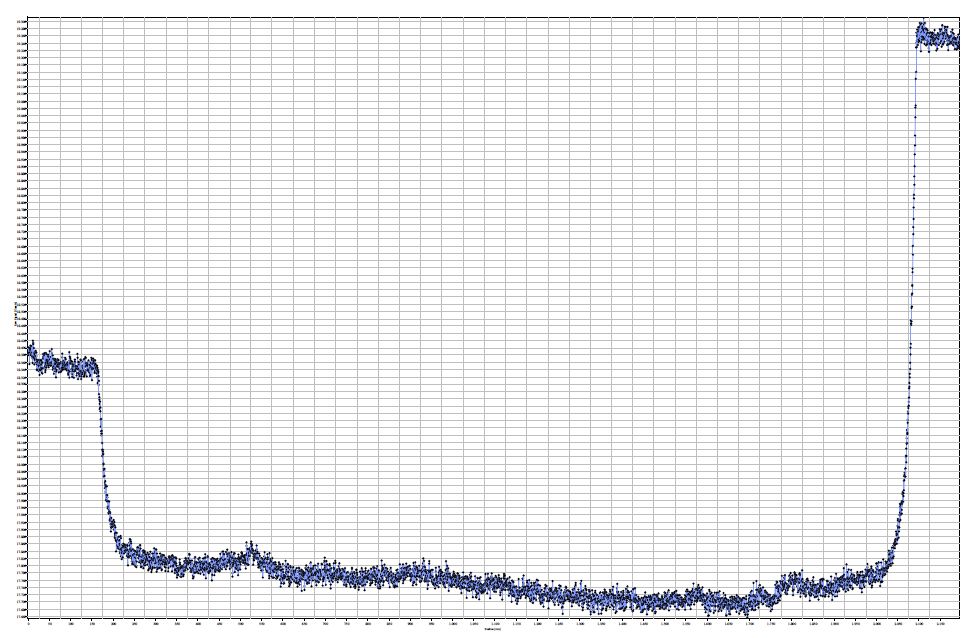

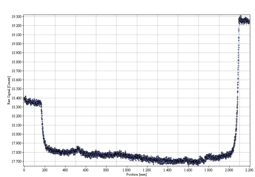

Re: Print Quality
Hi Nacris,
I did not have much time recently, but now I'm back with my problem.
I managed to print/save vector files (EMF and PDF), but the quality
issue is still there in terms of messed up scaling and fonts. The
screen output looks pretty nice, but the saved file does not!
I added an example which demonstrates the problem.
Hope you can help
Norbert
Hope you can help
Norbert

Re: Print Quality
Hello Norbert,
It seems that the resolution in the pdf is bigger than in the screen. This could explain why the fonts look smaller in the pdf.
Try setting a bigger font for axes labels and titles just before the exportation, and restore it after.
