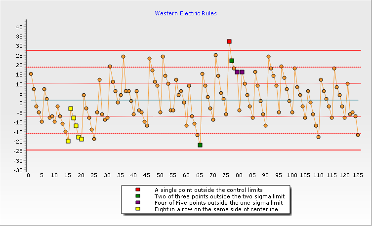

A look on your SPC-Sample in the Demo -> New Features -> Functions -> SPC gives rise to some questions for me. Im my opinion some of the points of the series a clear outliers beeing more than 3 standard deviations from the mean, so clear "out of control". They do not follow your rules beeing presented in the legend. What ist the reason for some points beeing presented as squares when others are shown in circles?
A squared pointer is to mark that a point accomplishes at least one of the rules implemented. This is what I get with the demo here:
Could you point to the points you think are not marked correctly? Otherwise, can you send an example demonstrating that?

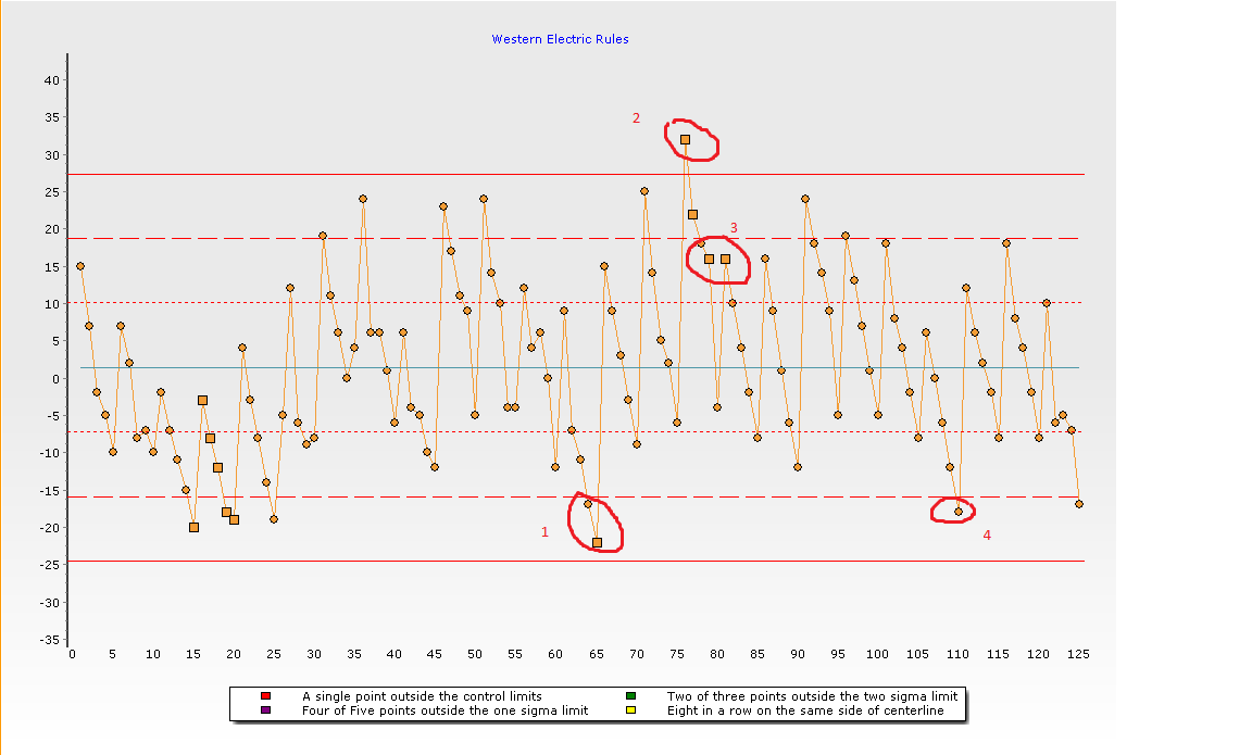

Your QC-Chart definitely looks different from the charts I get in the demo.
[img]
[/img]
All Points are shown in the same color. I can't find the reason, why for example the first point in area marked 1 is a circle and the second is a square, The second area shows two outliers where both points are squares. In area marked with 3 I can 't figur out the rules, why the two points are shown as squares.
I agree that the grafik you presented looks much better.
What did I miss in my demo?

Post by Narcís » Fri Mar 22, 2013 3:46 pm
Hi McStep,
I could reproduce this problem with the demo compiled with latest binary installers. The image I sent is generated with the demo compiled with our internal sources so probably it was a bug that has been fixed. We can try to compile a new demo and send it, if you like. Otherwise you may expect it to be fixed for the next maintenance release.

Post by Yeray » Mon Mar 25, 2013 1:05 pm
Hi McStep,
The last release has a problem with GetPointerStyle event affecting this (TV52016487).
You can wait for the next maintenance release, if you are a source code customer we can tell you in what does the fix consist so you can apply it yourself, or you could loop the series values and change the ValueColor[valueIndex] of the points according to the desired rules.
Ie, if the series being drawn is named Series2, and the color lines that control the limits are called ChartTool5 and ChartTool6 (as in the demo), here is how you could check the "outside control limits":
procedure TForm1.CheckRule1;
var valueIndex: Integer;
  for valueIndex:=0 to Series2.Count-1 do
    if (Series2.YValue[ValueIndex] > ChartTool5.Value) or
       (Series2.YValue[ValueIndex] < ChartTool6.Value) then
      Series2.ValueColor[valueIndex]:=clRed
      Series2.ValueColor[valueIndex]:=clTeeColor;
