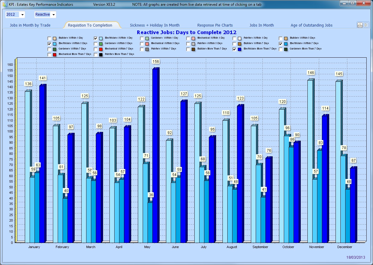

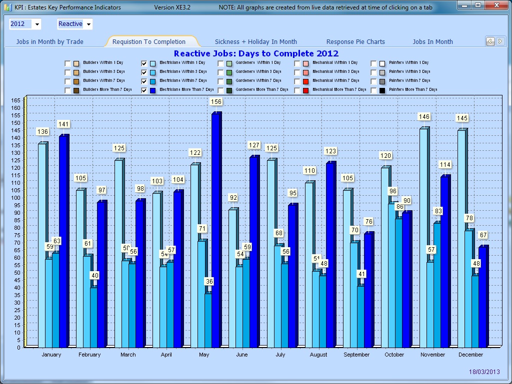

Is it possible to define a legend as a grid of Rows and Cols. The text is too great and so I have to use a small font which is hard to read. Additionally if the application is resized the legend layout is lost and sprawls poorly across several lines (see images attached)
Resized layout
KPI 2.jpg (382.43 KiB) Viewed 7720 times
Original Layout
KPI 1.jpg (318.4 KiB) Viewed 7763 times

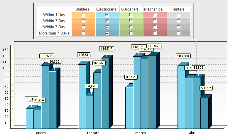

I was hoping to achieve something akin to this
This is what I hoped to achieve as it cuts down on repeated, though necessary text, in the legend.
KPI 3.jpg (35.09 KiB) Viewed 7643 times

As can be seen in the very first image, the legend loses its neat layout with all associated legends no longer in a straight vertical line down (effectively a column), which is represented in the second image.
However there is a lot of repeated text, and I wondered if it was possible to combine a consistent fixed number of rows and columns with the checkbox to switch on graphed datasets.

Post by Yeray » Wed Mar 20, 2013 5:01 pm
Hi Rob,
Have you tried using the TCustomLegendTool as Narcís indicated?
I've made a quite complete example:
  private
    { Private declarations }
    procedure DrawCustomLegend();
    procedure StringGrid1DrawCell(Sender: TObject; ACol, ARow: Integer;
                                  Rect: TRect; State: TGridDrawState);
    procedure ClickTool(Sender:TAnnotationTool; Button:TMouseButton; Shift: TShiftState; X, Y: Integer);
var
  CustomLegendTool : TCustomLegendTool;
  jobs  : Array[0..4] of string = ('Builders', 'Electricians', 'Gardeners', 'Mechanical', 'Painters');
  days  : Array[0..3] of string = ('Within 1 Day', 'Within 3 Day', 'Within 7 Day', 'More than 7 Days');
  colors: Array[0..4] of TColor;
var
  i, j, d: Integer;
  colors[0]:=rgb(226, 108, 10);
  colors[1]:=rgb(49, 133, 157);
  colors[2]:=rgb(118, 147, 57);
  colors[3]:=rgb(149, 54, 52);
  colors[4]:=rgb(128, 128, 128);
  CustomLegendTool := TCustomLegendTool.Create(Chart1);
  DrawCustomLegend();
  for j:=0 to length(jobs)-1 do
    for d:=0 to length(days)-1 do
        Color:=ApplyBright(colors[j], 80-(d*20));
        XValues.DateTime:=true;
        BarStyle := bsBevel;
        Active:=j=1;
        for i:=0 to 3 do
          AddXY(IncMonth(MonthOf(Today), i) , 30 + random*130)
  CustomLegendTool.Height := 120;
  with Chart1 do
    Legend.Visible:=false;
    Title.Visible:=false;
    Axes.Bottom.DateTimeFormat:='MMMM';
    Axes.Bottom.LabelStyle:=talPointValue;
    MarginUnits:=muPixels;
    MarginTop:=CustomLegendTool.Height + 20;
  Chart1.Draw;
  CustomLegendTool.Left := (Chart1.Width div 2) - (CustomLegendTool.Width div 2);
procedure TForm1.DrawCustomLegend();
var i: Integer;
  with CustomLegendTool do
    ParentChart := Chart1;
    AllowDrag:=false;
    AllowResize:=false;
    with Shape do
      RoundSize := 15;
      Pen.Width:= 2;
      Font.Style := [fsItalic];
      ShapeStyle:=fosRectangle;
    Grid.OnDrawCell:=StringGrid1DrawCell;
    OnClick:=ClickTool;
    with Grid do
      ColCount := length(jobs)+1;
      RowCount := length(days)+1;
      for i:=0 to RowCount-1 do
        RowHeights[i] := 20;
      ColWidths[0] := 120;
      for i:=1 to ColCount-1 do
        ColWidths[i] := 80;
      Height := 105;
      Width := 526;
procedure TForm1.StringGrid1DrawCell(Sender: TObject; ACol, ARow: Integer;
var
  seriesIndex: Integer;
  if (ACol = 0) then
    if (ARow > 0) then
      with CustomLegendTool.Grid.Canvas.Font do
      CustomLegendTool.Grid.Canvas.TextRect(Rect, Rect.Left+60, Rect.Top+1, days[ARow-1]);
  end
    if (ARow = 0) then
      CustomLegendTool.Grid.Canvas.TextRect(Rect, Rect.Left+35, Rect.Top+3, jobs[ACol-1]);
    end
      seriesIndex:=(ARow-1) + length(days)*(ACol-1);
      CustomLegendTool.Grid.Canvas.Pen.Style:=psClear;
      CustomLegendTool.Grid.Canvas.Brush.Color:=Chart1[seriesIndex].Color;
      CustomLegendTool.Grid.Canvas.Rectangle(Rect);
      TeeDrawCheckBox(Rect.Left+39, rect.Top+3, CustomLegendTool.Grid.Canvas, Chart1[seriesIndex].Active, clWhite);
      CustomLegendTool.Grid.Canvas.Pen.Style:=psSolid;
      CustomLegendTool.Grid.Canvas.Brush.Color:=clNone;
procedure TForm1.ClickTool(Sender:TAnnotationTool; Button:TMouseButton; Shift: TShiftState; X, Y: Integer);
var seriesIndex, nCol, nRow: Integer;
  with CustomLegendTool.Grid do
    MouseToCell(X-ColWidths[0], Y-RowHeights[0], nCol, nRow);
  if (nCol > 0) and (nCol<CustomLegendTool.Grid.ColCount) and
     (nRow > 0) and (nRow<CustomLegendTool.Grid.RowCount) then
    seriesIndex:=(nRow-1) + length(days)*(nCol-1);
    Chart1[seriesIndex].Active:=not Chart1[seriesIndex].Active;
