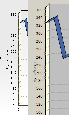

If the chart has a title for the left axis and the output is exported to PDF, the resulting chart will have the axis title positioned over the axis values. To recreate, do the following:
1. Create a new chart.
2. Add a series.
3. For the left axis, add a title.
4. Open the export dialog.
5. Select format as PDF.
6. Select the Preview button.
In the preview you will see that the title for the left axis is not in the correct position and is overwriting the axis values.

This is a known issue already listed on the defect list (TV52010840) to be fixed for future releases.
However, it seems to work better now than it does in the past. Could you please confirm if this is what you get?
The axis title isn't strictly overlapping the axis labels. There's no margin, but doesn't seem to overlap it.
The only alternative I can think on right now could be to use a virtual pdf printer to create your pdf

Yes it is.
