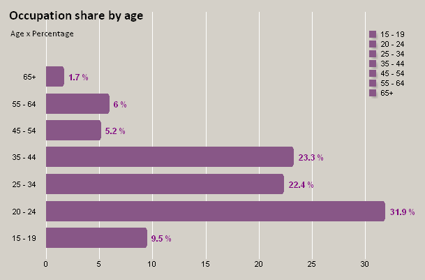

I have a problem with my Title, Subtitle and the Bottom Axis Grid when I change the position of the Title and Subtitle to custom.
When the title and subtitle are positioned automatically the grid lines for the bottom axis will stop just below them.
As soon as I change the position of the title and subtitle, the grid lines go through they position as visible in the attached image.
Is there a way to control the length of the grid lines?

When you change the title to use a custom position, the chart reserves no space for it. It should be done for you. Ie:
  Chart1.MarginUnits:=muPixels;
  Chart1.MarginTop:=20;

It works perfectly!
Thank you very much for your help!
